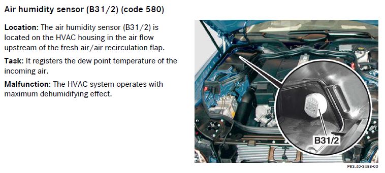

Old Jul 8, 2016 | 05:05 PM
konigstiger's Avatar
Posts: 15,901
Likes: 4,636
From: North Scottsdale, AZ
'71 Pinto
Originally Posted by PeterLech
My AC has been freezing up on long freeway trips, but that has been manageable as I usually drive locally.
"May" be humidity sensor part 2118300572.
File Type: pdf
