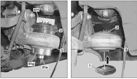

True,I have seen some get this done without the special mercedes press by just having the subframe and the wieght of the car itself seat them, but this was a w210. But even then how specialized can a rubber press be that warrents 800 dollars.
Here is how the press fits on the mount and frame during install, what general tools do you guys think could also do that job? Links would be great.

The pictures are poor quality, but I can't imagine how couple of sleeves and threaded rod can cost $800.
Fact is that I paid MB $150 for small chunk of steel machined to make injector puller.
Anyway, such tools can be substituted by big sockets, washers and heat-treated bolts.

On my 300TE i did the subframe by using the weight of the car to my advantage. Remove the bolt, use some wood to space it away from the subframe then use a large socket that fits through the hole and jack up until it's forced out. Then do reverse to install by jacking subframe against some wood to push the new one in.
The procedure should be similar for 211's. no cost for a special tool.
