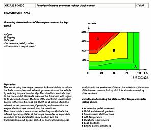

Slipping is when the lock up clutch doesn't fully engage and it slips, hence the name, lock up is when the lock up clutch in the torque converter locks up, hence the name.
Here's a picture on the behaviour of a 722.6 transmission torque converter so you can understand better
Source of graph
https://mbworld.org/forums/c-class-w...-question.html
P0811 is your fault code for excessive clutch slippage, here is where I referenced it from
