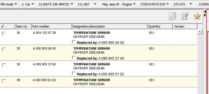

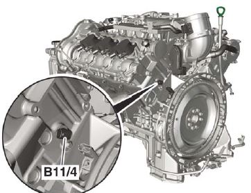

P0016 (MB 1208), P0017 (1200) = balance shaft.
P0116/0117 = coolant temperature sensor.
Attached Thumbnails 2006 E350 4Matic engine codes 0116/0117 how to troubleshoot-sensor.jpg   2006 E350 4Matic engine codes 0116/0117 how to troubleshoot-capture.jpg   2006 E350 4Matic engine codes 0116/0117 how to troubleshoot-0016.jpg   2006 E350 4Matic engine codes 0116/0117 how to troubleshoot-0017.jpg   2006 E350 4Matic engine codes 0116/0117 how to troubleshoot-0116.jpg
