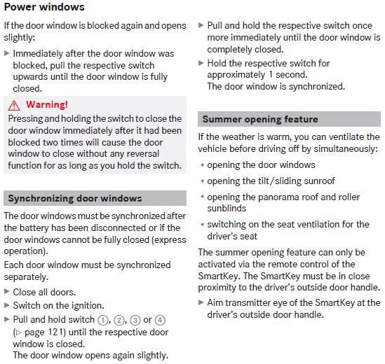

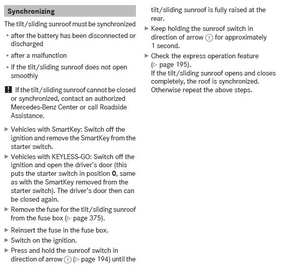

Following replacement of the battery, I have noticed a couple of peculiar things. To wit:
>Driver's side window...when raising the window, I need to hold the button in the lift position until it closes. (I guess the Express feature only is applicable to lowering the window; right?) However, once the window is closed and I release the lift button, the window opens (!) about a 1/2", requiring me to again activate the lift button for a moment.
>Sunroof operation. When closing the sun roof from its "rear edge elevated" position, the sunroof closed but then partially re-opened when I released the switch!
Weird...these two anomalies are actually kind of similar in nature; i.e., the glass structure closes but then slightly re-opens.
I suspect the battery replacement has caused some kind of synchronization problem. Comments?

Resynch per OM (no need to remove fuse)...
