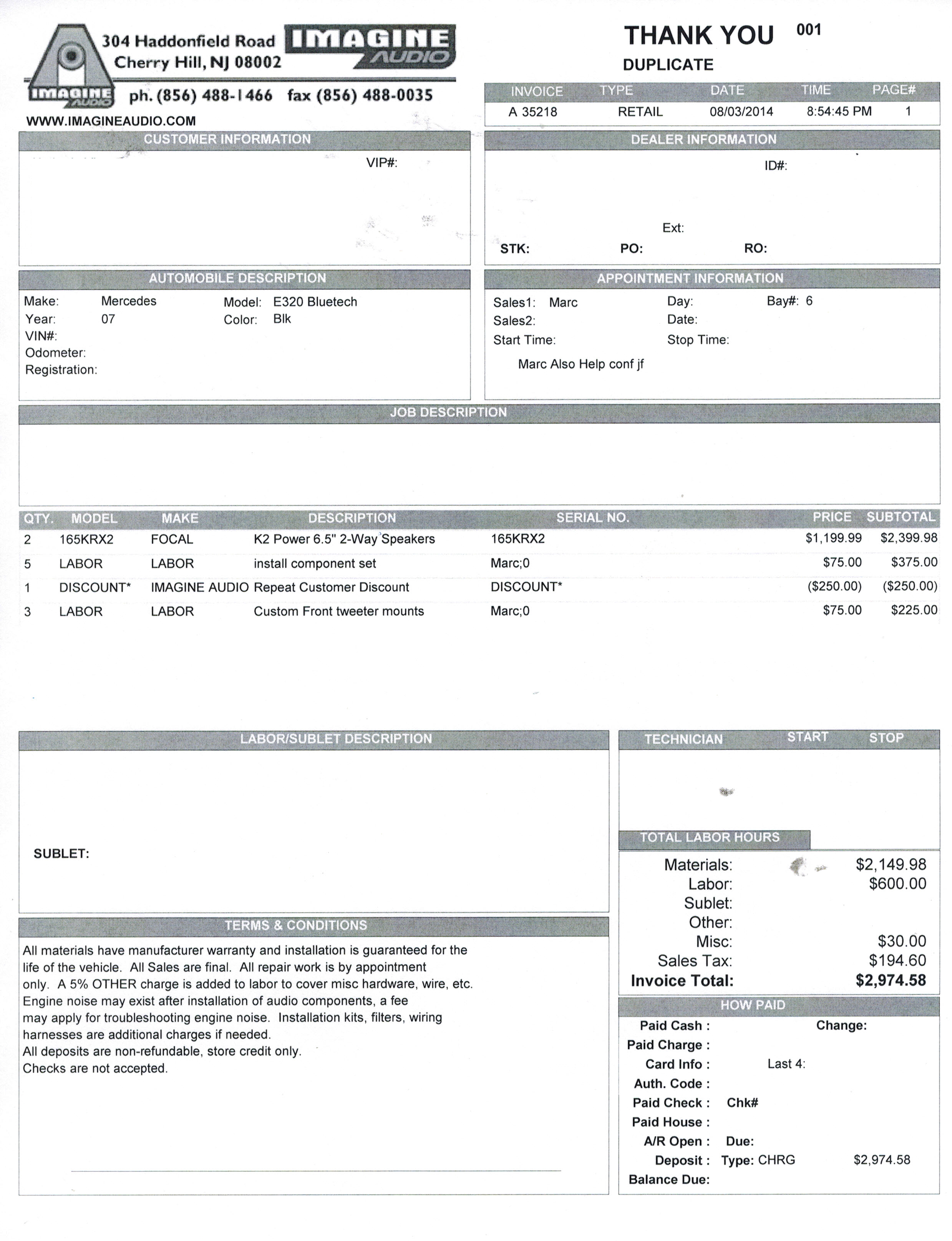

Nope. Still have the same command and functionality; I needed more volume (mids and trebles) hence the amp and door component speakers did the trick for me. Don't go crazy like me for Focals, I paid full price though think they cost a little less now.
In very simple terms, assuming you are handy at DIY and if original speakers are not blown and all you want is more volume/sound, you could try adding a reasonablly priced (I use that term very loosely) 4-channel power amp in the trunk, splice door speakers output from the OEM amp(in the trunk) using as input to external amp (make sure the amp can take speaker input), then wire door speakers to the output from external amp. This will give you a good bang for the buck.

Looks like they used the whole fist and went wrist deep.

Yeh. That's sweet but out of my league. You were right best leave mine as is. Old guys wish list EMF.
