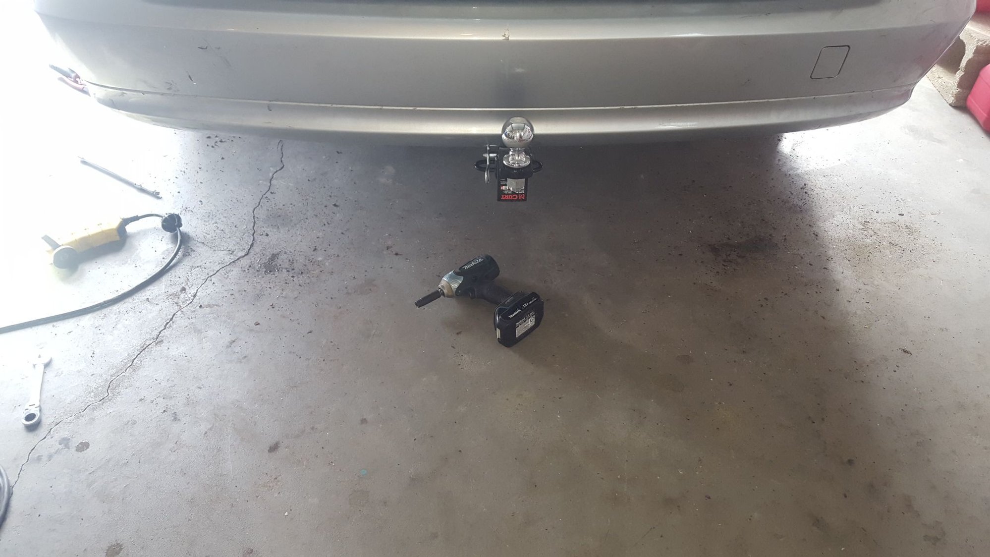

I installed my hitch this weekend. I would say it took me ~2 hours to do with trial and error. If I had an electric or pneumatic ratchet and removed the bumper first it would have gone quicker, I tried installing the hitch with the bumper on the car.
I hope this helps!
Let me know if you have any questions.
I have not done any brake light/turn signal wiring.

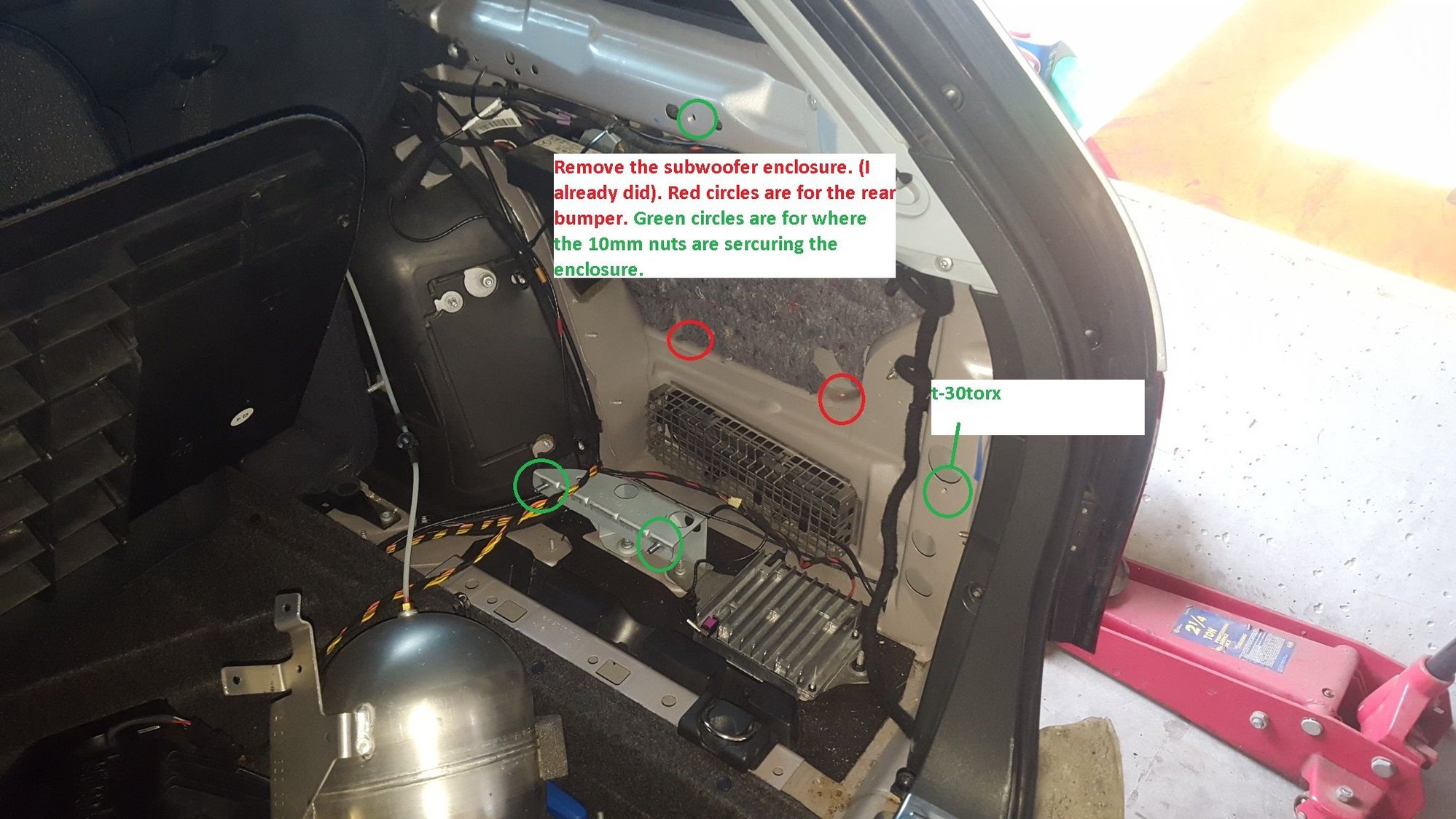

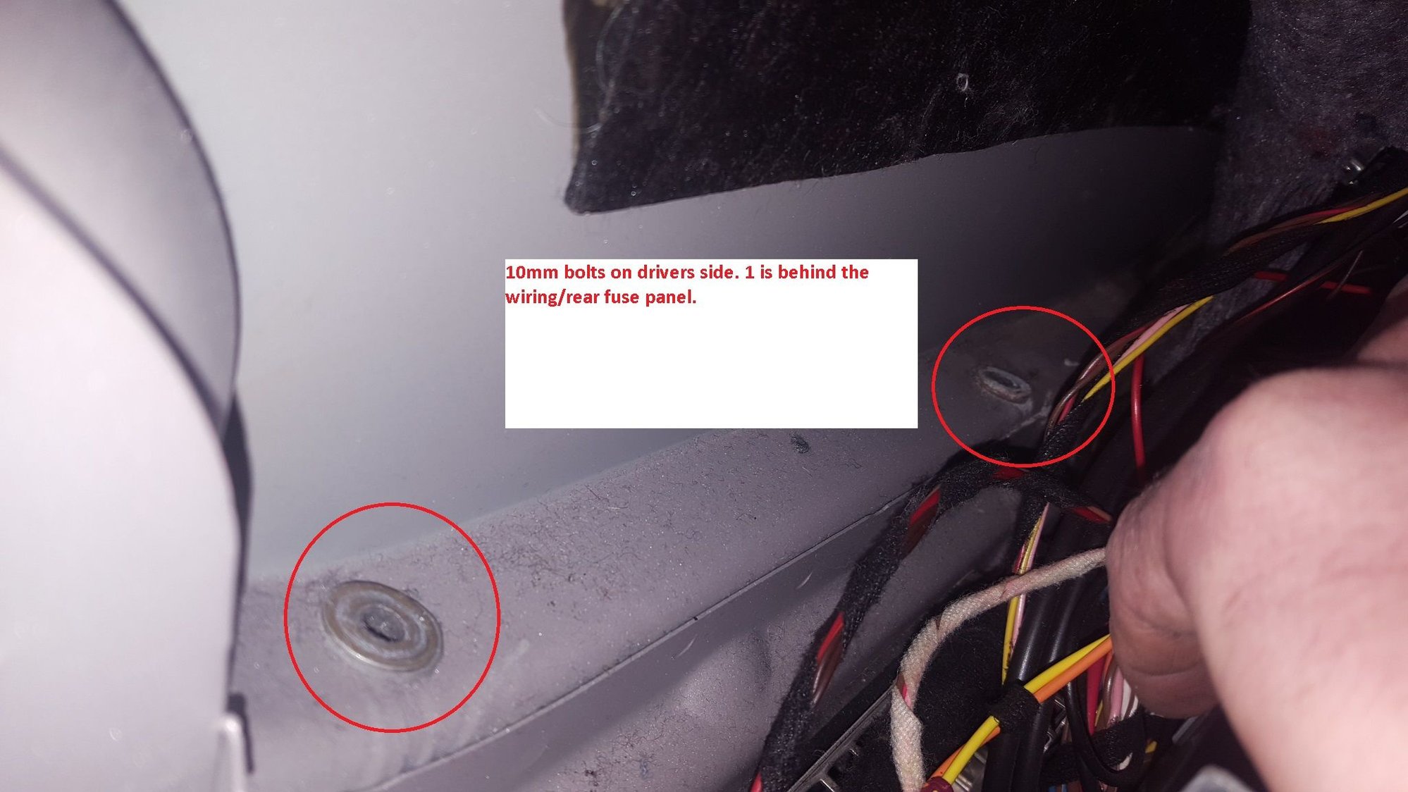

1. Remove rear hatch side trim panels (no pics of how to) if you cannot do this then stop and have someone install your hitch.
2. Remove sub-woofer on passenger side and the Airmatic reservoir.

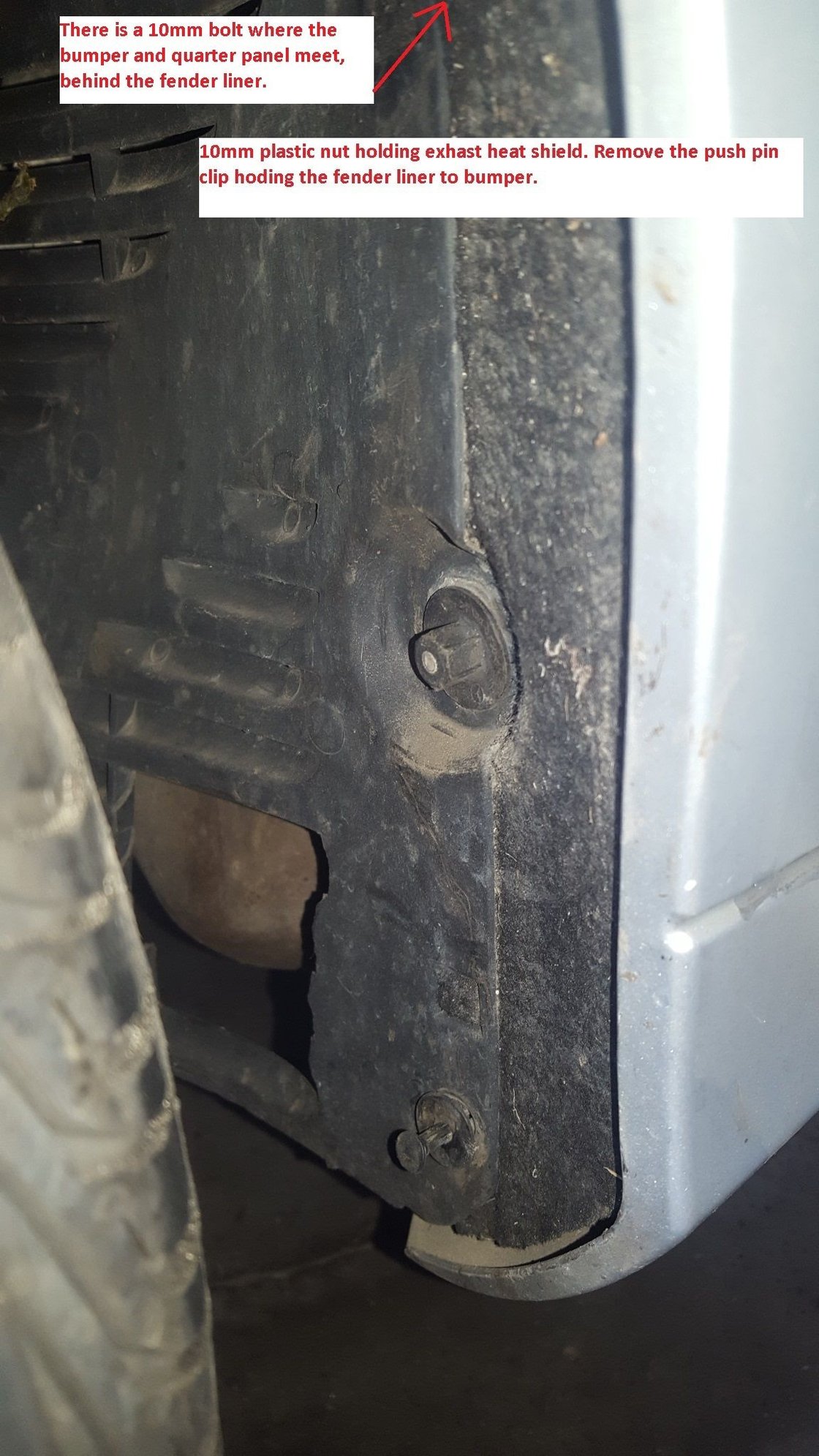

Remove clip and 10mm plastic nut. There is a bolt behind the fender liner that holds the bumper to the quarter. (I forgot that pic)
3. Slide bumper back to remove. A second set of hands would help but not needed.

6. Install the hitch. A second set of hands would make it easier but not needed. Sorry about not having a good pic of the hitch without the bumper on, but mounting points are pretty self explanatory.
7. Put it all back together.
