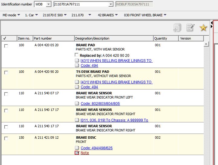

I have a 2005 E500. VIN WDBUF70J05A797111. I need Front Rotors and Pads Napa lists two parts, one w/sport package and one w/o. Neither fit my car. Went to Napa because the dealer is 50 miles away but now I am going to the MBD. The rear pads and rotors from Napa fit perfectly...
I am wondering, while waiting for the dealer to get back to me, if there is something special about this car? When I bought it, used, the MBD told me that this is a German Car. That the original owner actually went Germany to select it... ??? Thanks, Jack

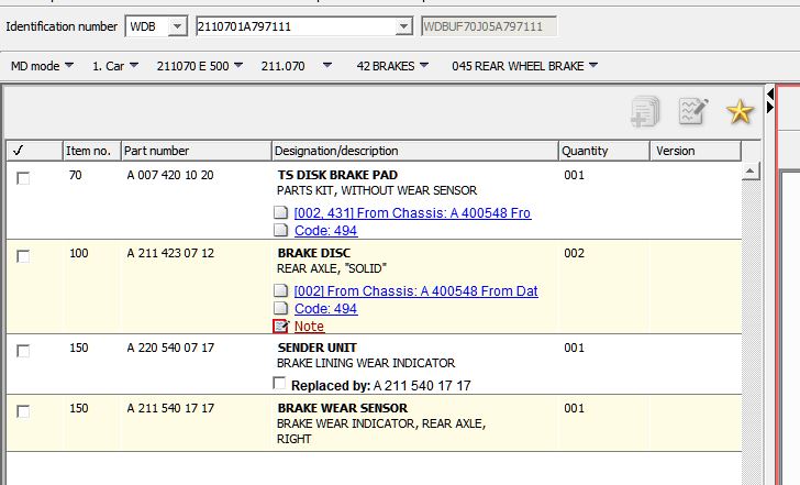

EPC OEM part #s:
Attached Thumbnails Brake Part Issue????-front.jpg   Brake Part Issue????-rear.jpg

I'm back from my 100 drive to the MBD. Had to special order the rotors. Part Guy assured me that PN 211-421-09-12-64 is the correct part.
Nice day for a top down drive in my SLK-55 AMG.
Old Jun 1, 2017 | 02:07 PM
FCPEuro's Avatar
Former Vendor of MBWorld
Joined: Dec 2014
Posts: 1,142
Likes: 154
Mercedes
Your parts guy is correct
