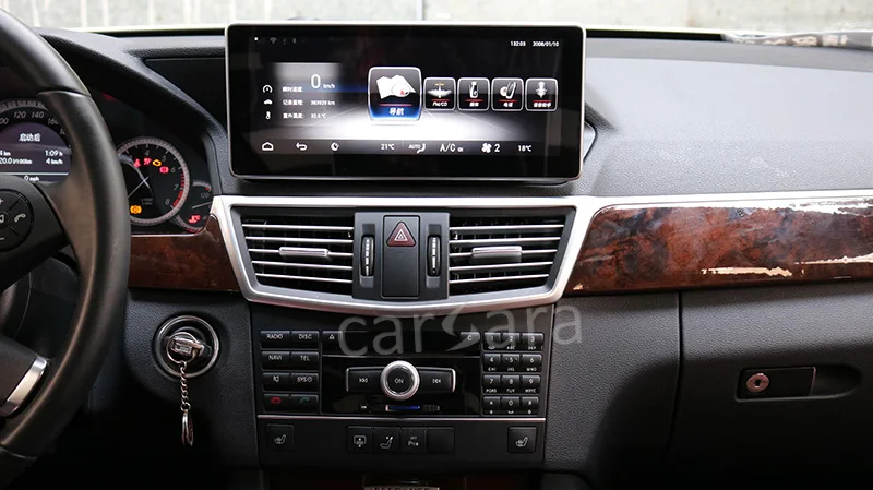

hi, by any chance do you know how to reverse the menu screen? I attach photos
