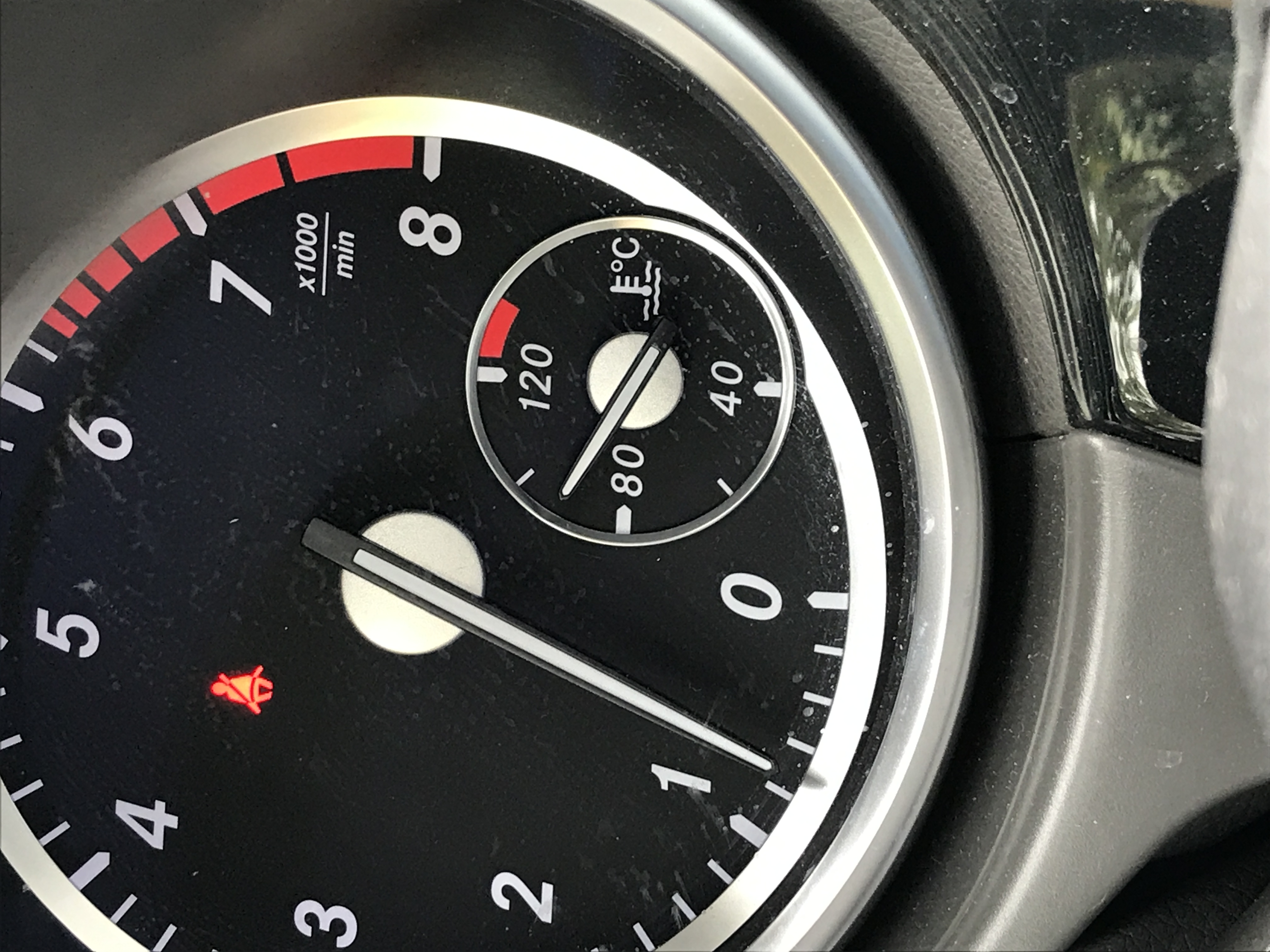

Is it normal?
Thanks

I have a different guage than yours but my engine temperature stays exactly where yours is. i.e. ~100C. It goes to 120 on kick down though and it has been one of my worries. I want to nail it before I throw any money on parts on radiator, pump etc.
