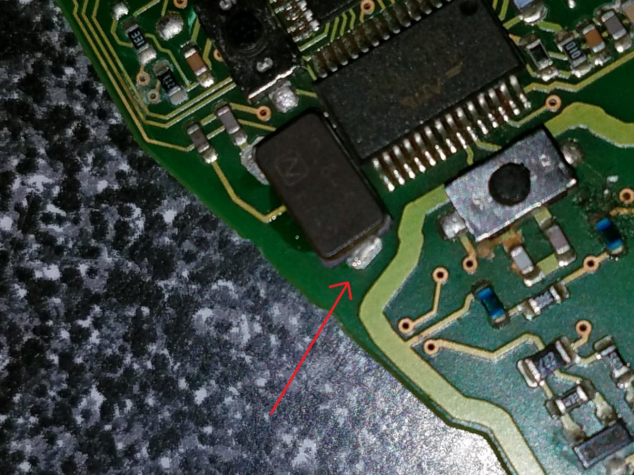

Thanks, Single key scenario.
the fob buttons didn't unlock prior to the no start issue.
Today when I looked at the Fob circuit in well lit conditions, I noticed there is a chip (one that has just two end connections) was broken off one end.
When I press down on the chip, I am able to see the red led on unlock/lock etc. I am going to re-solder it and from there see if It works.
I am afraid the EIM went into security lockdown, but with working buttons I might be able to bring it out of that.

ok, startup is FIXED!
the coil on the key circuit had it's front most post loose as well. I carefully heated and reflowed the solder and they key was back to normal.
door locks still don't work, but the fob now lights up red when buttons are pressed. I told my girlfriend to run get a new key because this one is falling apart and will fail again.

That key shows water damage.
