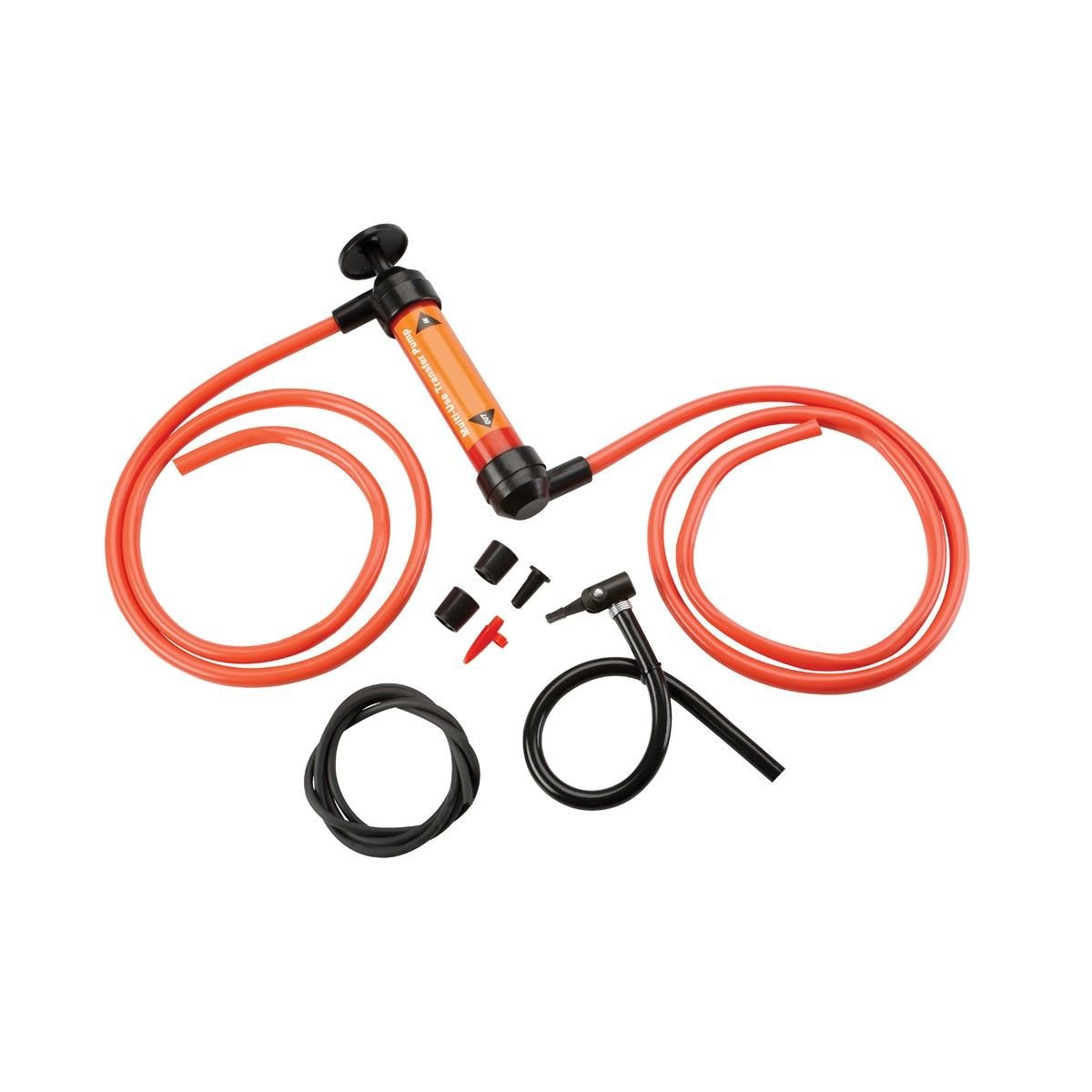

Got the plugs out with the magic Kroil. The case was filled a bit above the inspection hole previously. I was able to get a bit extra in the inspection hole with the HF transfer pump hose. Pumped in 650ml and sealed it up
https://www.harborfreight.com/multi-...ump-63144.html
