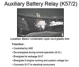

Has anyone ever changed out the aux battery relay? MB says mine is bad and wants $550 to replace. I know this can be a DIY project, I just need to know the location.

Part # 0025423819, see attachments.
Attached Thumbnails How to replace the AUX Battery relay-capture.jpg   How to replace the AUX Battery relay-capture2.jpg

Changed Aux Battery Relay
I had an error message with convenience functions not available. Changed the aux battery relay and fixed the problem. Quite easy, unplug battery, remove wipers, take off plastic cover and then replace the relay. All you need is 10mm and 13mm deep sockets
