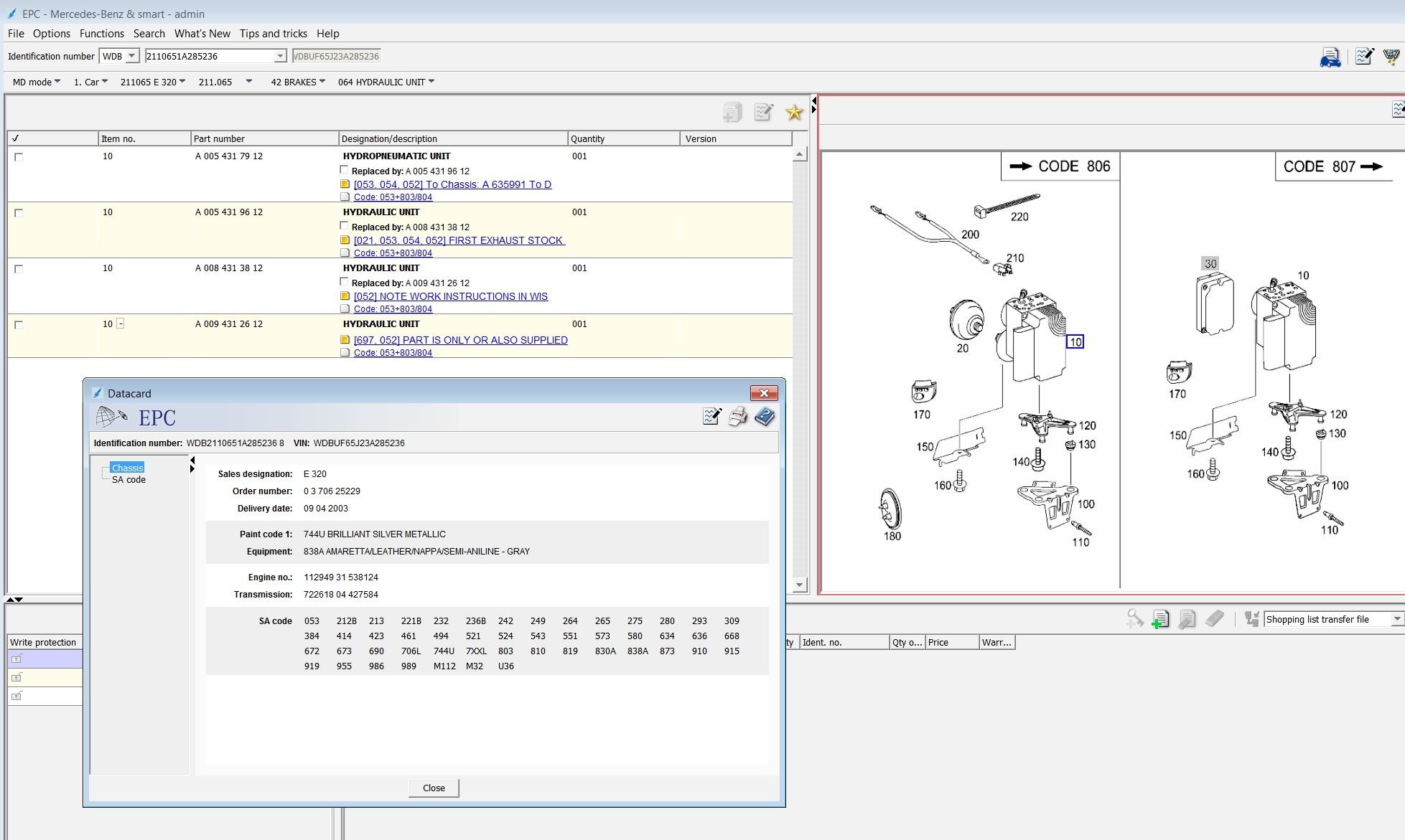

Hi there, what SBC to get?
WDBUF82J54X119260 - W211 2004 E320 4MATIC 211.082 option 804

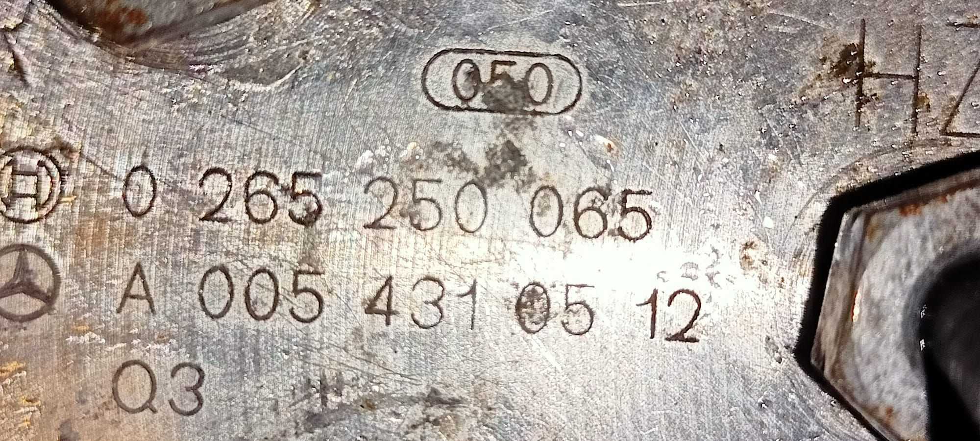

SBC in car : A 005 431 05 12 Q3 / BOSCH No. 0 065 960 019
SBC with VIN in EPC(2019 self contained) : A 005 431 79 12 no 'replaced by' for 211.082 / A 005 431 05 12 does not exist
A 005 431 79 12 is the same for 211.065 but has 3 'replaced by' : A 005 431 96 12 / A 008 431 38 12 / A 009 431 26 12
Every replacement has the code : 053+803 / 804 =? 053+803 OR 804 would that be correct?
Assuming that it is correct - what trouble am I getting into if I get an SBC No. A 009 431 26 12 Q3?
Why the heck would an SBC for a RWD differ from a 4MATIC when they both had the same initially?
Thanks for your help.

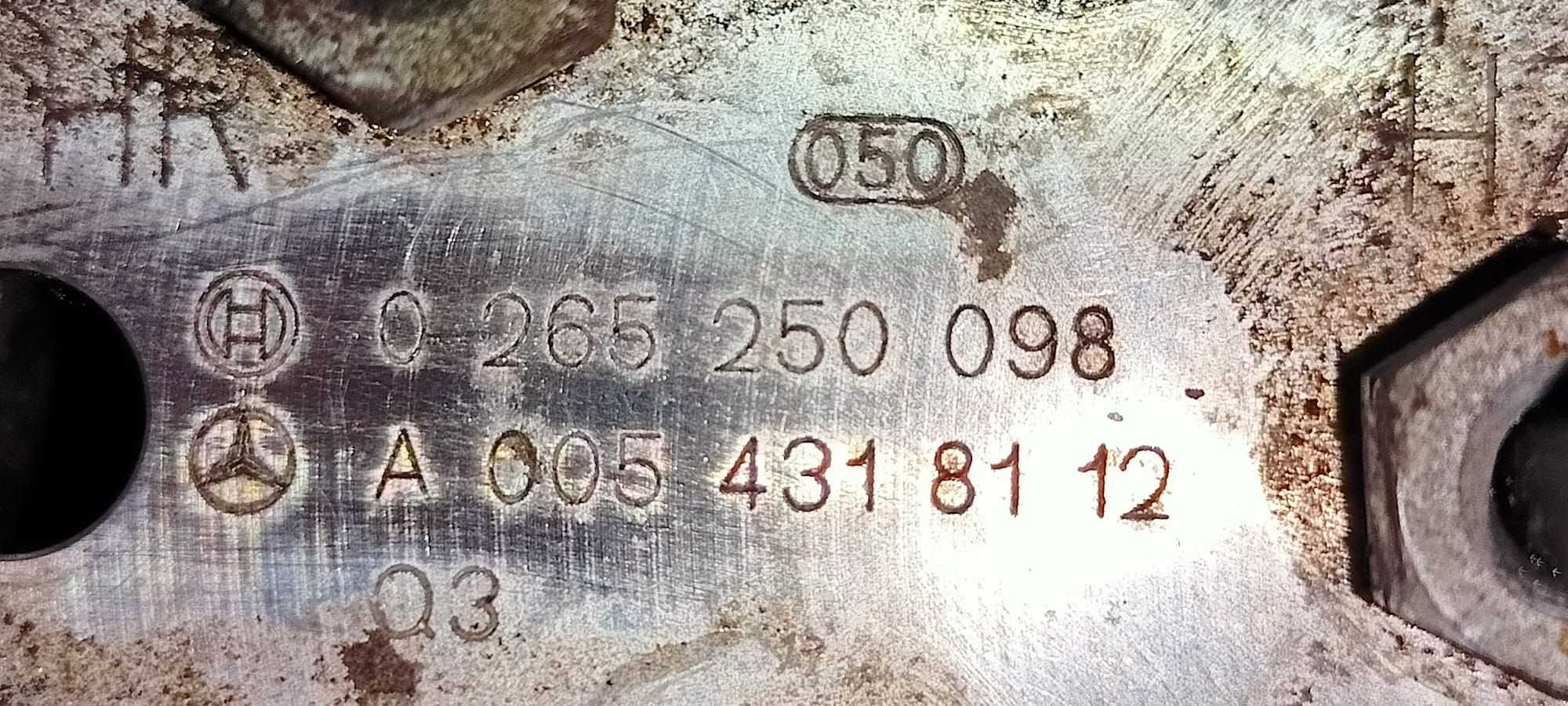

Hi folks , I have my SBC down and red message appears Reduce braking power , I tried to get it fixed but with no success , it will cost alot with MB dealer so I am looking for:
1: sbc replacement number
Also, if I got the replacement unit should it conveyed with the esp control or can I use the original esp control
Original sbc number : A005 431 5112

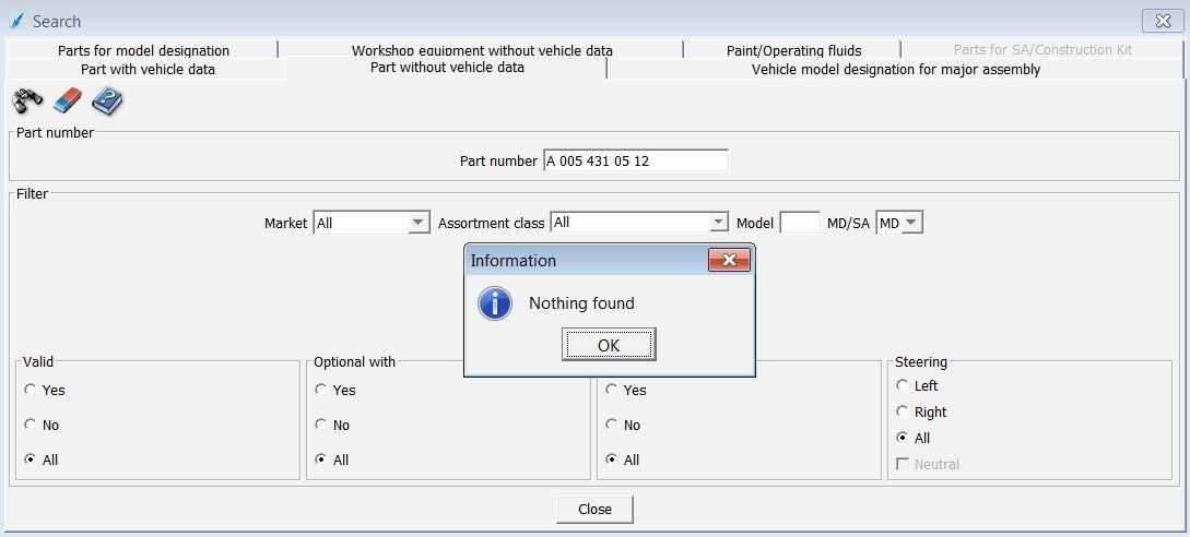

Disclosure, I'm not a professional but I do have the EPC(2019)
Original sbc number : A 005 431 51 12 - Nothing found
See attachement for VIN/SBC numbers

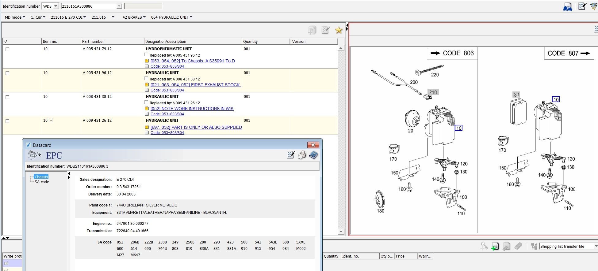

hello, i am new to this forum, i saw how you helped with sbc numbers a fellow user of this forum, i have a similar problem, my sbc was faulty and a mechanic changed it it with the sbc of a c class (mine is e270cdi), now it gives problems again but i dont have the numbers of the original sbc, if you could do the same with my Vin number, WOULD HELP ME A LOT, i am struggling eoth this for months now. Any help is greatly appreciated WDB2110161A300886

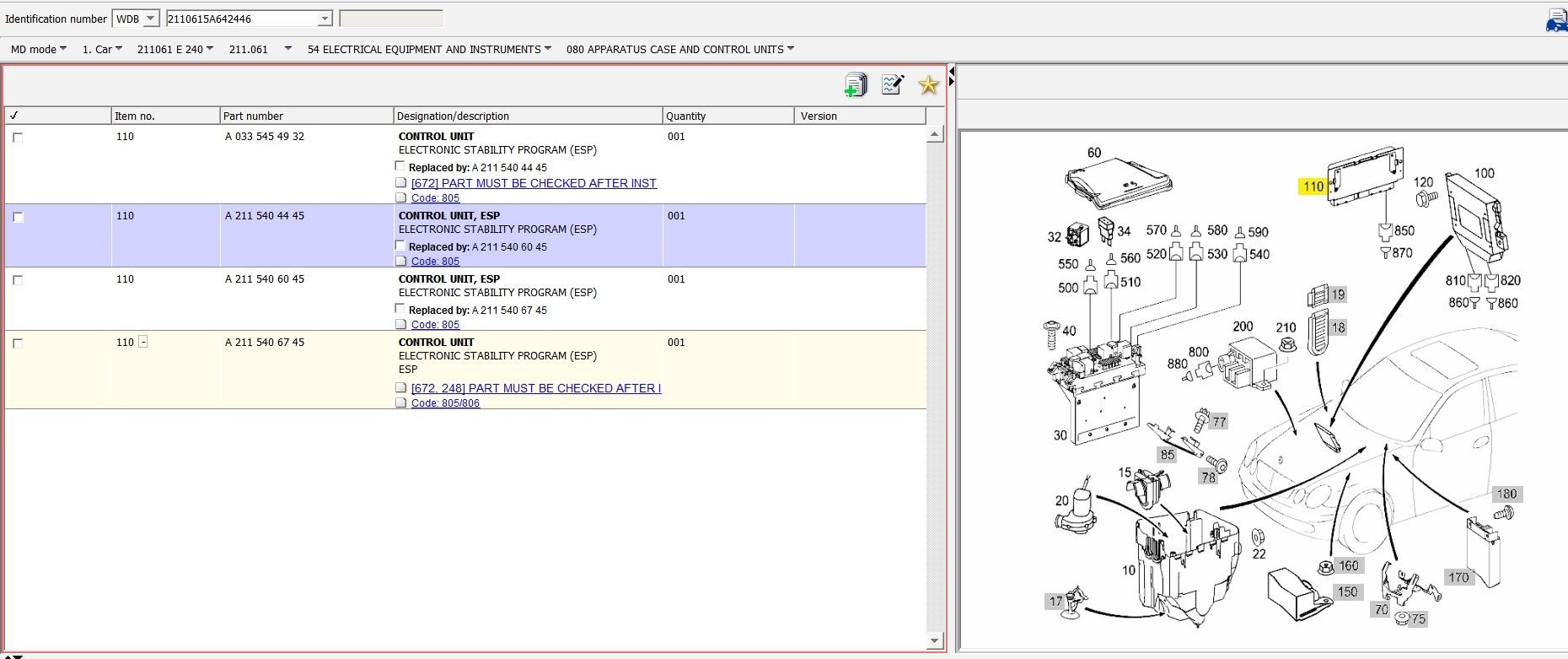

Hello Ahmed
From your VIN WDB2110615A642446 here is the info for ESP
I can't confirm compatibility... I'm no expert. Hope it helps.

From your vin, here is the info I have.
