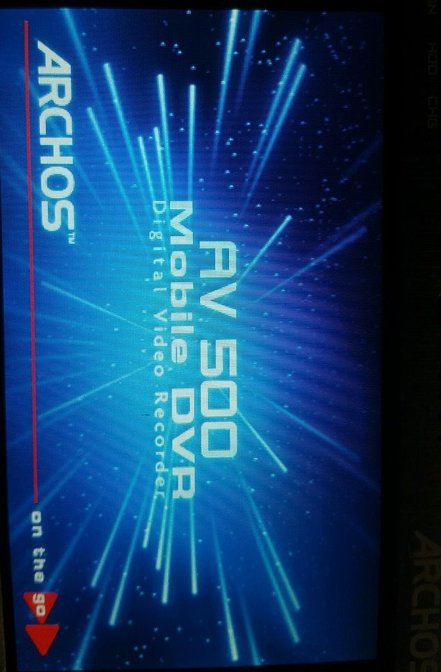

Selecting the music I play
Originally Posted by 850csi
Don't quote me on this but I believe, at least for the US, 2003-2004 R230s use NTG1 COMAND and d2b while 2005-2008 R230s use NTG2 and MOST.
So I think this should work with any 2005-2008 SL.
I simply removed the CD changer from the storage cubby behind the driver seat, spliced the Mr12v device’s power cable into the CDC’s power line, and plugged it in with the new power line and the CDC’s MOST plug. I leave the device in the cubby — I think I’m going to “mount” it inside the cubby with some velcro tape. There’s really no need to have ready access to it.
So I got a MR 12V as well and have in the place where my CDC used to live - I now take have an Archos pocket recorder [they come 30 or 100 GB HD drives ] inside my center console that via the MP3 cable feeds the music to the MR 12V Aux port
The Archos let me select music [via it's screen] random - A-Z - By Artist - custom playlist or any file that I can create when I have the Archos connected to my PC where it will show up as an additonal HD when connected
The screen size is 3.5 x 2 inches
The outside dimensions are 3x5 inches
This is just an example of custom list

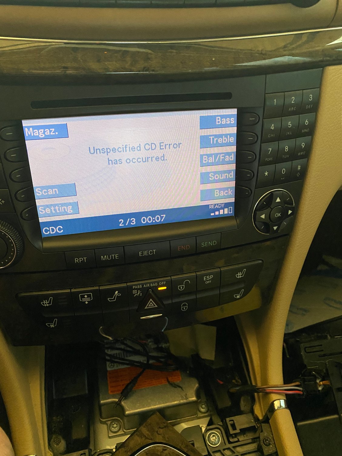

Has anyone ever gotten the 'Unspecified CD Error' with using Mr12v? Seems to happen if I stress the thing out messing with it too much like switching between sources, walk out of my car to with phone (while on and paired) then return to car, or sometimes when phone calls start/end. basically I get the message then CDC disappears from the list on command and it doesn't come back until I restart the car.
Also been having some issues with the phone functionality lately. It was working fine but now, If I call someone, the command shows the number being called but when they answer, the command screen switched back to BT_Audio mode and displays Track 2 but the person is still on the Phone. OR I call someone and when they answer, the audio just doesn't work (but remains paired to CarKit) and I have to switch to my phone as the source so they can hear me. When this occur, I also end up getting the error and CDC disappears from list. Its quite annoying. Anybody ever have any of these issues?
Lastly, can someone link a good fiber extension cable? The link earlier in this thread was to a loop, not extension. Will this work?
Amazon Amazon

If you tried resetting it and it's still acting up.....Sounds like it may be on the way out?
