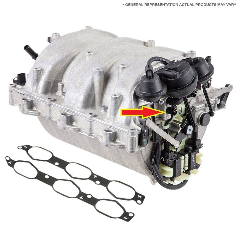

I am looking everywhere for this plastic part. Dealership doesn't have it. Ebay, can't find it. Junk yards want me to buy a whole manifold from them.
Where can I find this plastic part as seen in the image?

Pierburg makes the manifold. That doesn't really look like a common part that fails. Most repair kits are just the lever or the arms. I think MB's standard response is to replace the entire manifold so I'm not surprised you can't find it. You may be stuck with getting a new or rebuilt manifold. A new one is about $465
https://www.fcpeuro.com/products/mer...ierburg-516475
A rebuilt one is $350. Even if you fix it, it's a common failure item. Only worth fixing if you just intend to get rid of it soon.
