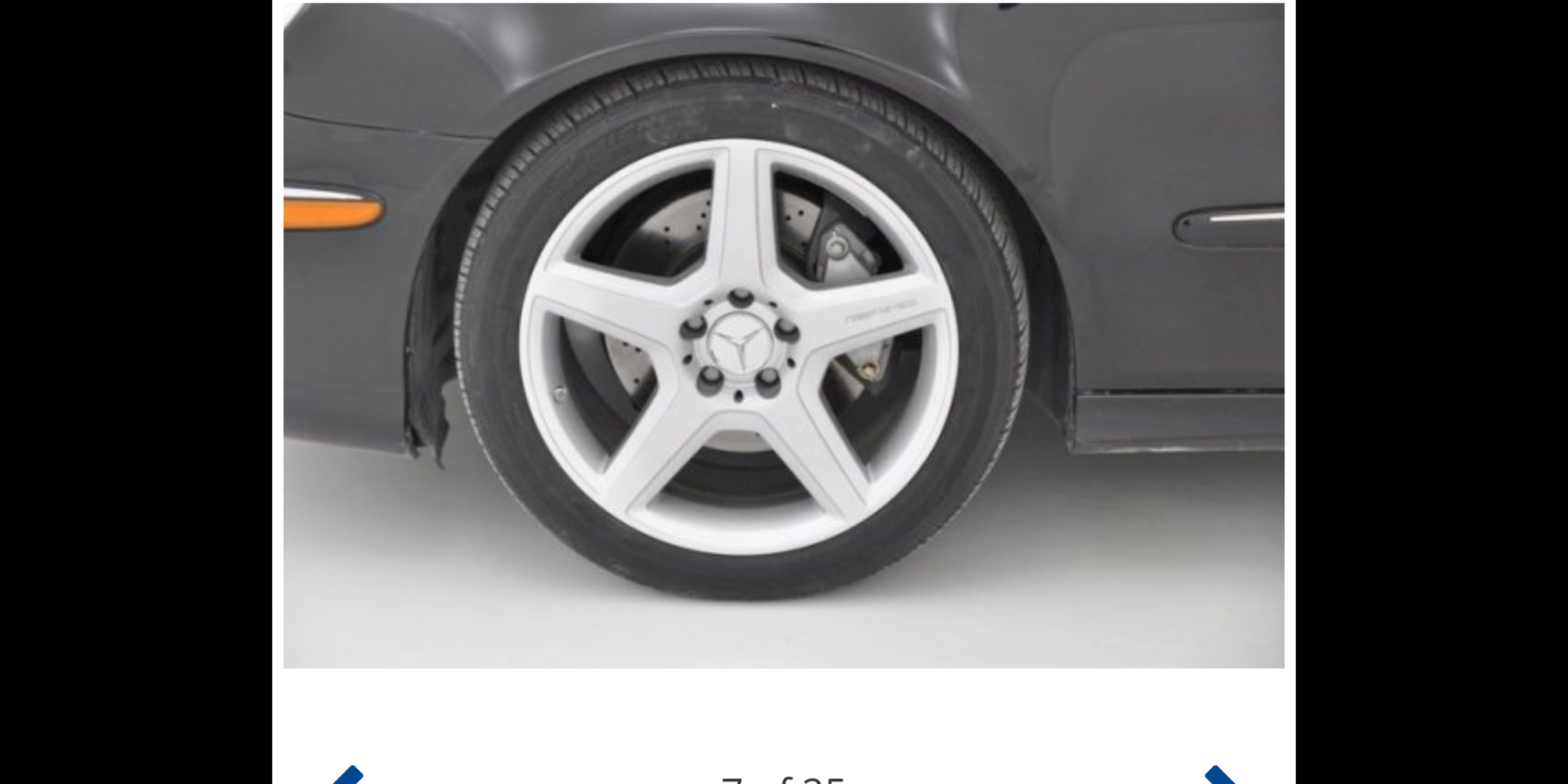

Seems very low in this picture.
Old Feb 20, 2018 | 01:39 PM
Strigoi's Avatar
Joined: Jan 2010
Posts: 3,249
Likes: 257
From: Richmond, CA
2001 E320 Wagon, 2006 LBZ Silverado, 2007 E63 (sold), 2001 E55 (sold)

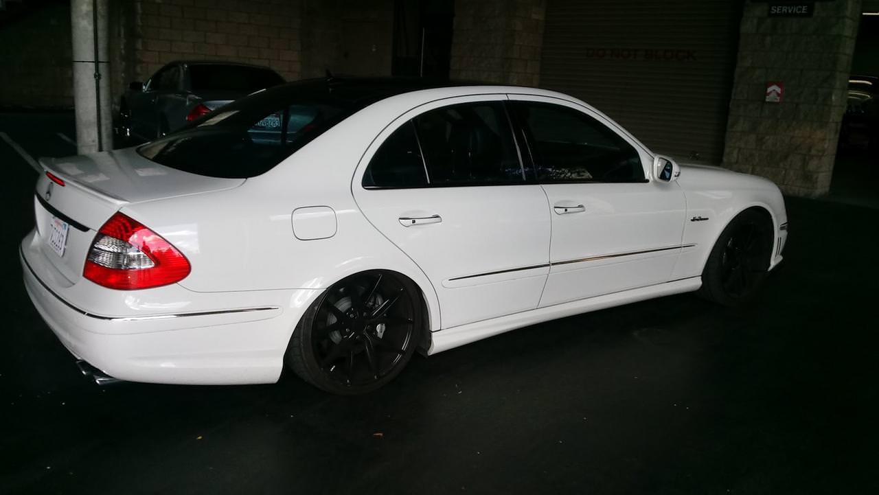

Edit: Do you have a full side shot of the car? It looks like it's probably lowered a bit going off that one pic.
For reference, here's my E63 with the rear suspension fully bottomed out. You don't want to see one of these cars looking like that.

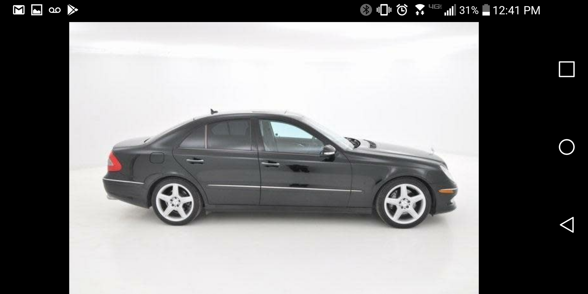

Full side shot doesn't seem bad.. Just a lot tighter wheel gaps than I'm used to perhaps.
Old Feb 20, 2018 | 01:44 PM
Racin_fool's Avatar
Joined: Feb 2007
Posts: 809
Likes: 74
From: Dallas, TX
2008 E63 wagon (1 of 62)
Yeah, that does look a little lower than it should. If you go check out the car again, you can always take a peek inside the wheels at the shocks/springs and see if there is something other than a black coil spring in there. Usually the aftermarket stuff is something other than black. The other way to check is to get an alignment performed and have them check the actual ride height of the vehicle versus what it should be using a Hunter alignment setup and an angle sensor such as a Rommess gauge.

What is the purpose of the 63 photo? jw cause there are very few 350's in america with full airmatic, sedans that is....
Like the above said, broken coil springs. And or the fact the tire profile on the 2wd's differs front to back may also be skewing the ride height as well. fronts 40 profile while rear is 35. Looks stupid as hell too me. I too have a 09 2wd and had to have same profile on all fours.
Because I spend most of my time in the AMG section where all the cars have Airmatic unless people have swapped in coil overs. I forget that some E Classes came with springs instead.
I also explained why I put the pic in the post.
