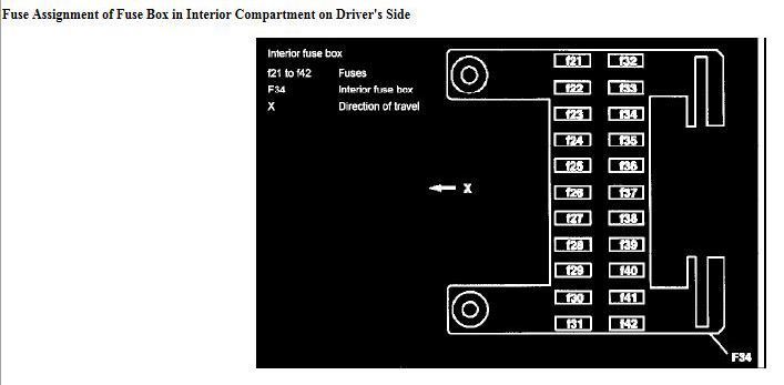

Old Mar 8, 2018 | 10:34 AM
Jay Inthavong's Avatar
Joined: Mar 2018
Posts: 7
2003 Mercedes e500 w211
Yea I saw that last night when I went to go check. "Fuse 15amp" hopefully this will work "crosses fingers"
Old Mar 8, 2018 | 01:15 PM
Joined: Mar 2018
Posts: 7
Talking
Originally Posted by nivram13
Drivers side fusebox pull fuse F037 no more error.
Or if you have Xentry just code it out.
HEY THANKS MAN IT WORKED!!!!!!
