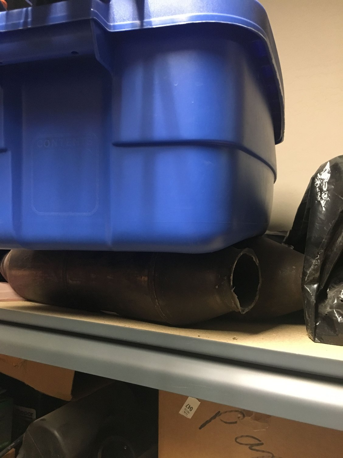

You need another yard. Cats only and a full end to end exhaust for a Viper. I didn’t go to Dodge to get them. I just searched Craigslist for exhaust Mercedes and got multiple hits for totaled out cars.
