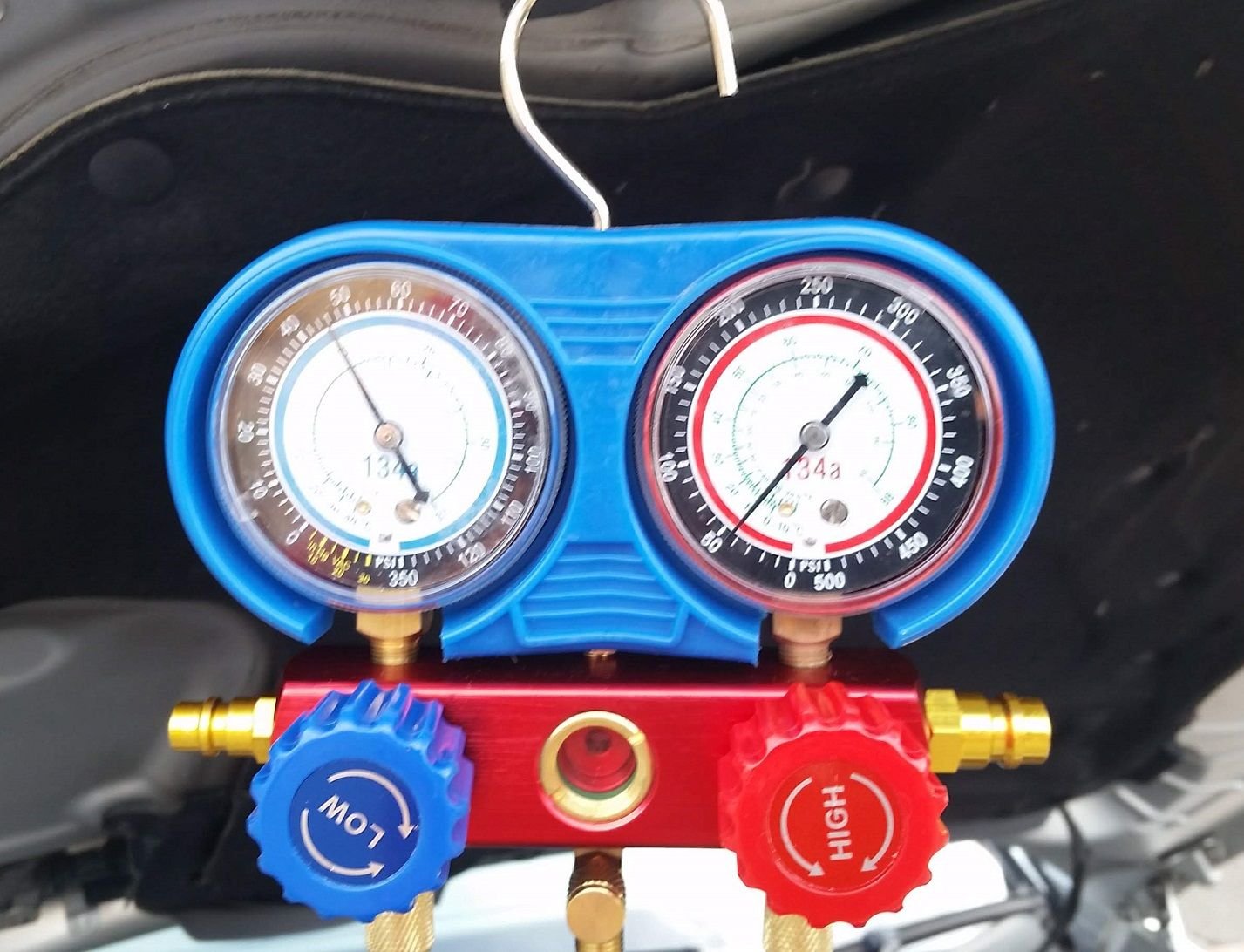

Thanks for answer guys, still no luck for me.
I managed to check pressure in high and low systems and it looks like both pressures are the same around 50 psi, which I am sure indicates some issue.

I always try to avoid tapping into pressurized system as that has potential for opening additional problems.
But anyway, what you have measured is 50 psi = 3 bar of pressure.
That most likely is too low to activate the system. And again - without proper troubleshooting this is just educated guess.
You had small refrigerant leak, so my best advise is to put a can of R134 + dye in it.
That should restart the system and potentially let you pinpoint the leak.
DON'T put any other crap in the system!
