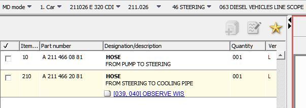

Old Oct 2, 2018 | 10:39 AM
konigstiger's Avatar
Posts: 15,901
Likes: 4,632
From: North Scottsdale, AZ
'71 Pinto
Originally Posted by Toomuchmula
do you know what hose this is so I can look for it online
Low pressure 2114662081 (includes plate), high pressure to pump (no plate) 2114660881.
