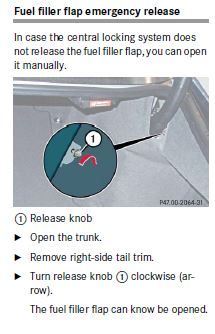

The fuel flap on my 2006 E320 CDI doesn't open despite having locked and unlocked the car several times. How can I fix this problem? Thanks for your help.

pull the trunk liner and disengage the lock pin from the inside.
You can also try swapping out relays in the trunk fuse box to see if you just have a bad relay. Looks like they're the top two (yellow) relays in that fuse box.

Thanks a lot. I'll give it a try.
