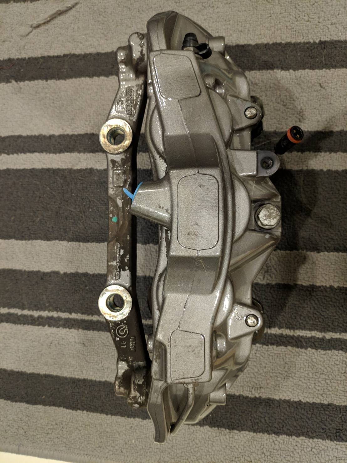

Hello from Thailand,
Would like to have a little help for AMG brake kits 6/4 on my baby 2006 E200KOM FL Avantgarde wagon please.
I currently have 18" AMG new ST3 wheel 8.5 offset 38 + 9 offset 39 with front brake 4 port 330*32 mm and the rear 2 port 300*10 mm. But now I'm in process to acquire AMG kits 6/4 port.
The guy offers me AMG calipers 6/4. The front has code 20.9553.01 A and the rear has code 20.9568.02 1A.
He told that it was removed from SL55 (not sure which model). I've done searching through internet and E63/SL55/CLS63 should fit with the caliper.
So a little help, is this fit on my W211 wagon?
Super Thks for all answer.

The AMG calipers use larger mounting bolts. You'll have to redrill and tap your spindles.

I got the answer from ebay which the bracket for e63 w211 code 19.7661.13 and 19.7661.12. So this one does not directly fit. Thks for all answers.
