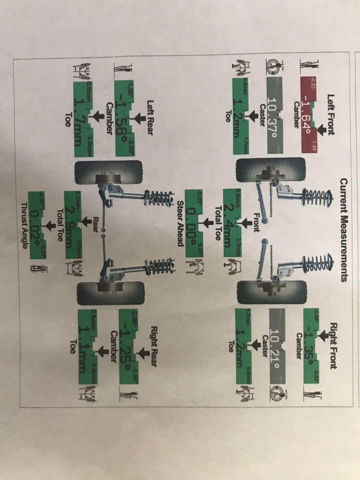

Always, always, always have your alignment shop giveyou a sheet like this after an alignment: (Note: not my car measurements; only an example is shown)
I did my alignment at my local tire shop and once they were done, they said I was "all set" and I drove off. However, referring to the previous post, I showed the tire shop guys my E550 unable to "self-center" itself after each turns, even regular right, left, and U-turns, they told me this was all part of the "break-in procedure" of new tie rods. I told them I also updated the suspension with new sets of front control arms on both sides, and also sway bar links, etc. I noticed the car would "self-center" itself whenever I backed up, like backing out of a parking spot or my driveway. It only didn't "self-center" itself when the car was in "Drive". Thus, I ruled out the steering rack being the issue here. Trusting my gut, I still thought there was an issue because I had filled up gas twice already during the week, and drove almost 200 miles back and forth from school and the car still was having the same symptoms after it drove off the lot at the tire center.
Turns out, after bringing it to my local mechanic/body shop, they figured that the alignment done at the tire shop was WRONG! Furthermore, they didn't give me the alignment sheet showing "before and after", so who would have known the alignment was off. After doing a diagnosis, my local mechanic said the tire shop had actually made the "toe" to 25cm on both sides when the "toe" for my E550 should've been around 0.7cm-1.7cm (I recall somewhere around there). Toe was readjusted and all is good now. U turns, left turns, and right turns all turn very well. Car handles like new!
Moral of the story: Have a before and after sheet for an alignment given to you and also cross check work done at shops with other shops.

I had the same issue with alignment last week, do you happen to have the standard alignment specs for w211 so I can compare it to check alignment of my car?

Here were my alignment specs:
This pic was after the alignment was done (the second time lol)
