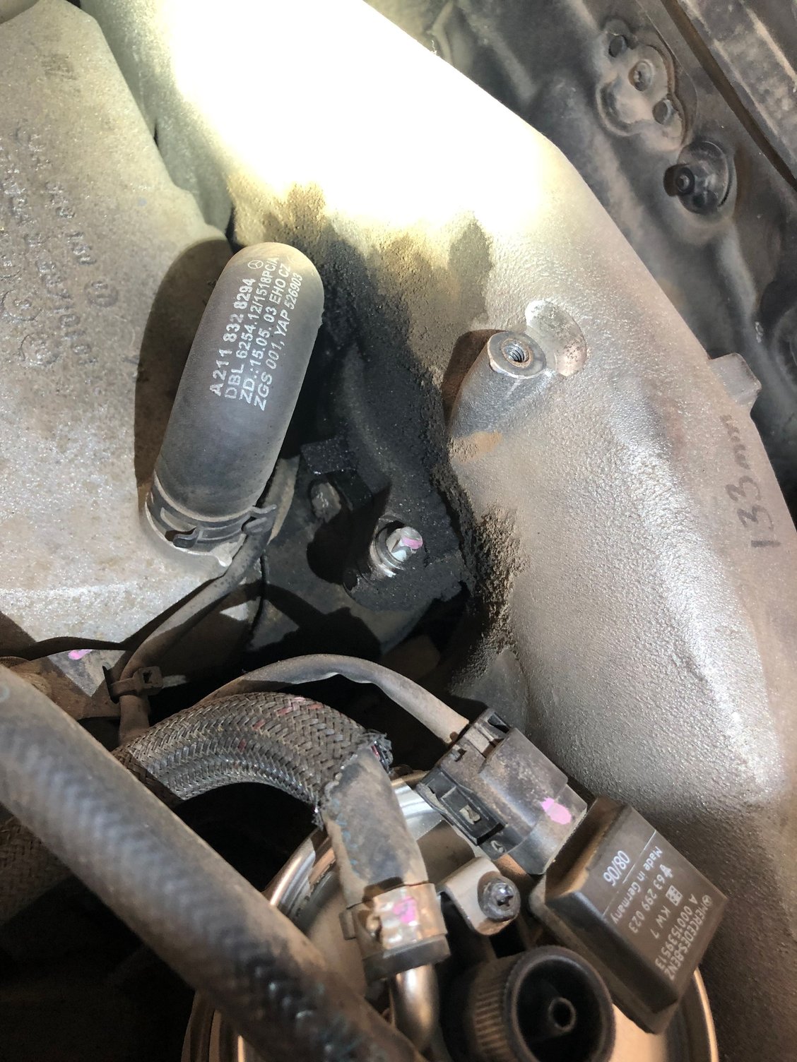

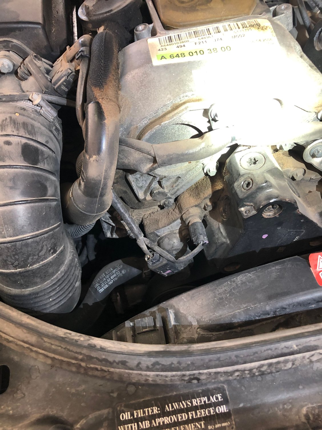

I was looking around the engine bay today for fun yes I do that I randomly take my engine cover off to see if my engine is happy. Today it wast happy I noticed a leak. I don稚 know what it is and that is why I知 here to get some info and see if anyone痴 ever DIY this repair. Thanks in advance. 4th pic from the top.

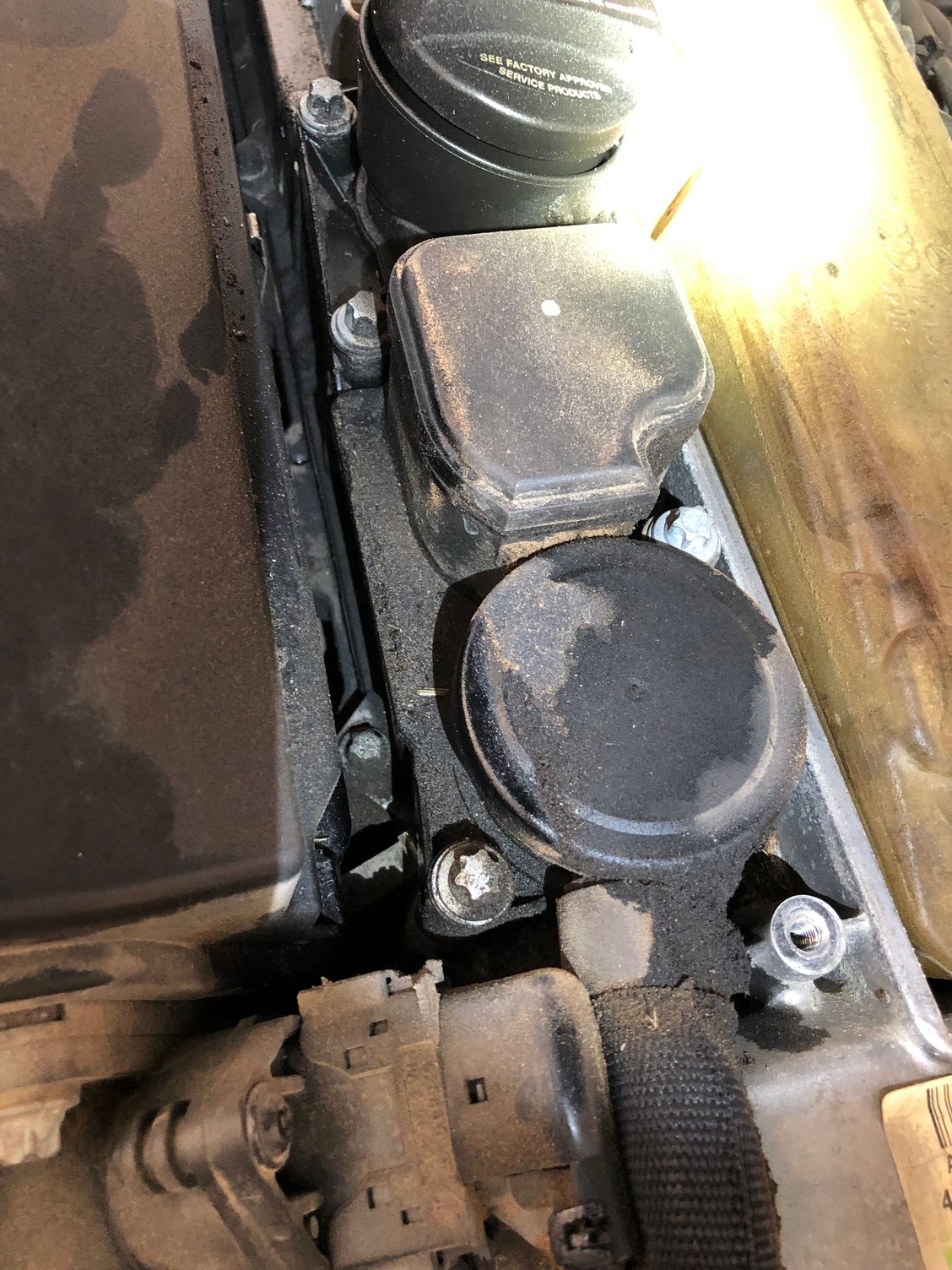

The oil cap has a seal under the entire peice, it is leaking. The intake was unbolted and rebolted too loosely and is leaking on the other side. I had both of these issues and new gaskets ($20) fixed it.

ok, do you happen to have part numbers for them? Also I tried to look at a diy it seems to be a big job but i may be wrong, should i try to tighten the bolts see if that will fix it? Whats the best course of action here?

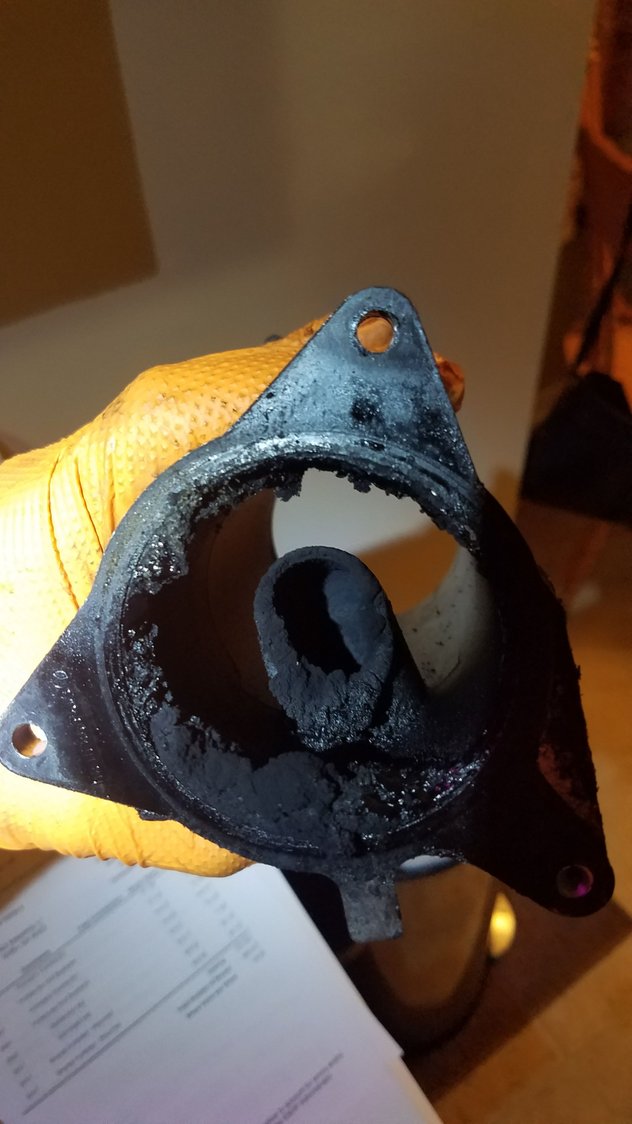

I took the intercooler pipes and the connector that attached to the intake( were your leaking on the drivers side) to clean them out. It was ridiculously clogged. When I reattached with the old metal gasket, it leaked like yours. I replaced with a new metal gasket and it is still weeping. Not sure why. It is a bit of a chore getting it off because you do have to take a number of parts off but it is diy, just given yourself enough time. Also my oil cap leaks after 3 different mercedes oil caps and a new air/ oil separator. Not terrible but it eventually makes a mess. Still trying to figure it out but the wife drives it daily so it doesn't get a lot of down time. Let me know if you figure it out.
Needed cleaning. Same part that is leaking on your drivers side.
