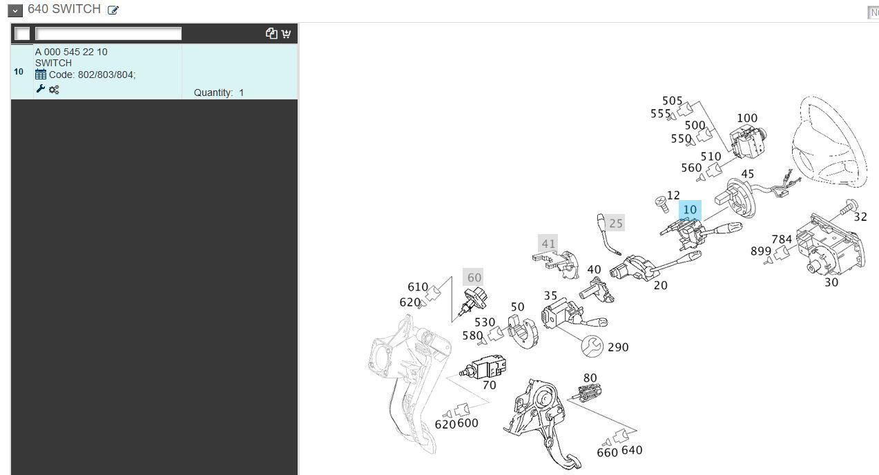

Consider replacing combination switch (10 in diagram) should be part # 0005452210, need VIN to confirm part #.
https://www.pelicanparts.com/techart...eplacement.htm
WDB2112261A514042
IT works with left signal when i push the washer button and then stops again
