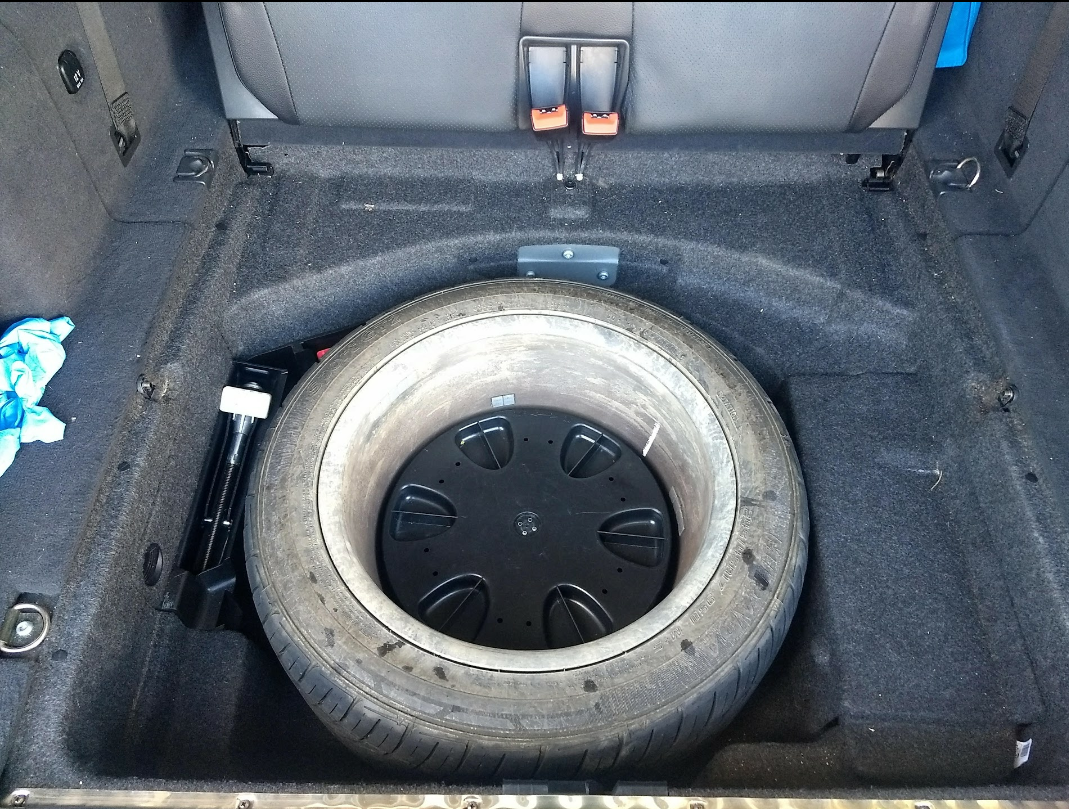

225/55R16 full size spare fits perfectly in a sedan. Some markets got this kind of spare tire from the factory.
Floor sits flush.
And in the wagon again 225/55R16 is a perfect fit even with the 3rd row seat right above it. The trunk floor sits flush.

A regular tire fits in the hole where they have the spare (donut)?
I like that idea if it works, otherwise will not have any room in my trunk.
Will have someone try it out.
