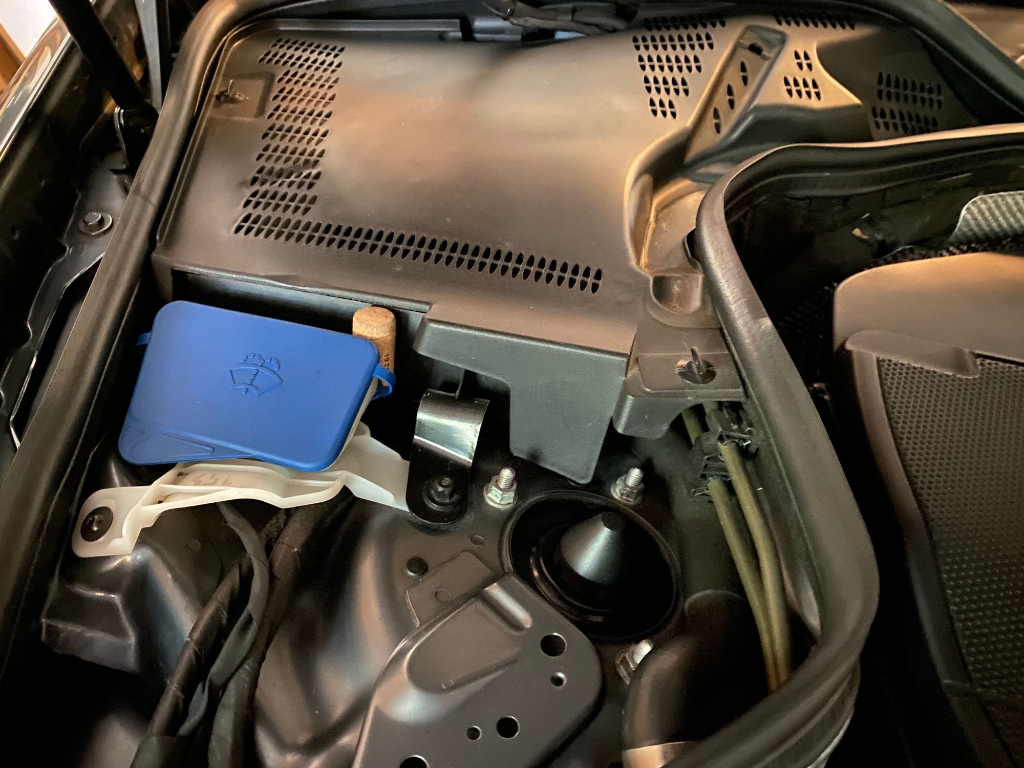

instead of buying a new housing, i wedged in a wine bottle cork to push and hold cabin filter housing securely. The cork is placed between the housing and windshield fluid tank.
Now, The car with AC or Heat does not smell any more.

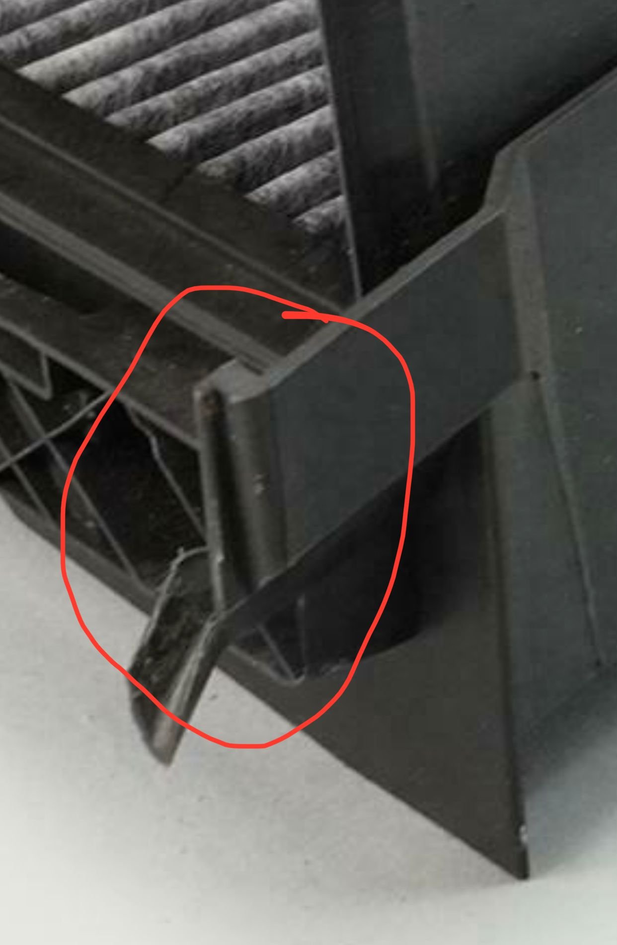

Do you have a picture of the side clips?

The circled part in Pic 1 is missing in my unit.
The unit is supposed to be installed from top amd pushed in until the side clips locks in. Note this is looking at the pics of a normal unit.
Here i noticed the smell goes away only if the cork is in the center of the housing, as shown in Pic 2, As this pushes in the unit uniformly and sealing all sides.
In my first attempt I had placed the cork to the left of the housing, and noticed that while it helped it did not get rid of the smell entirely.

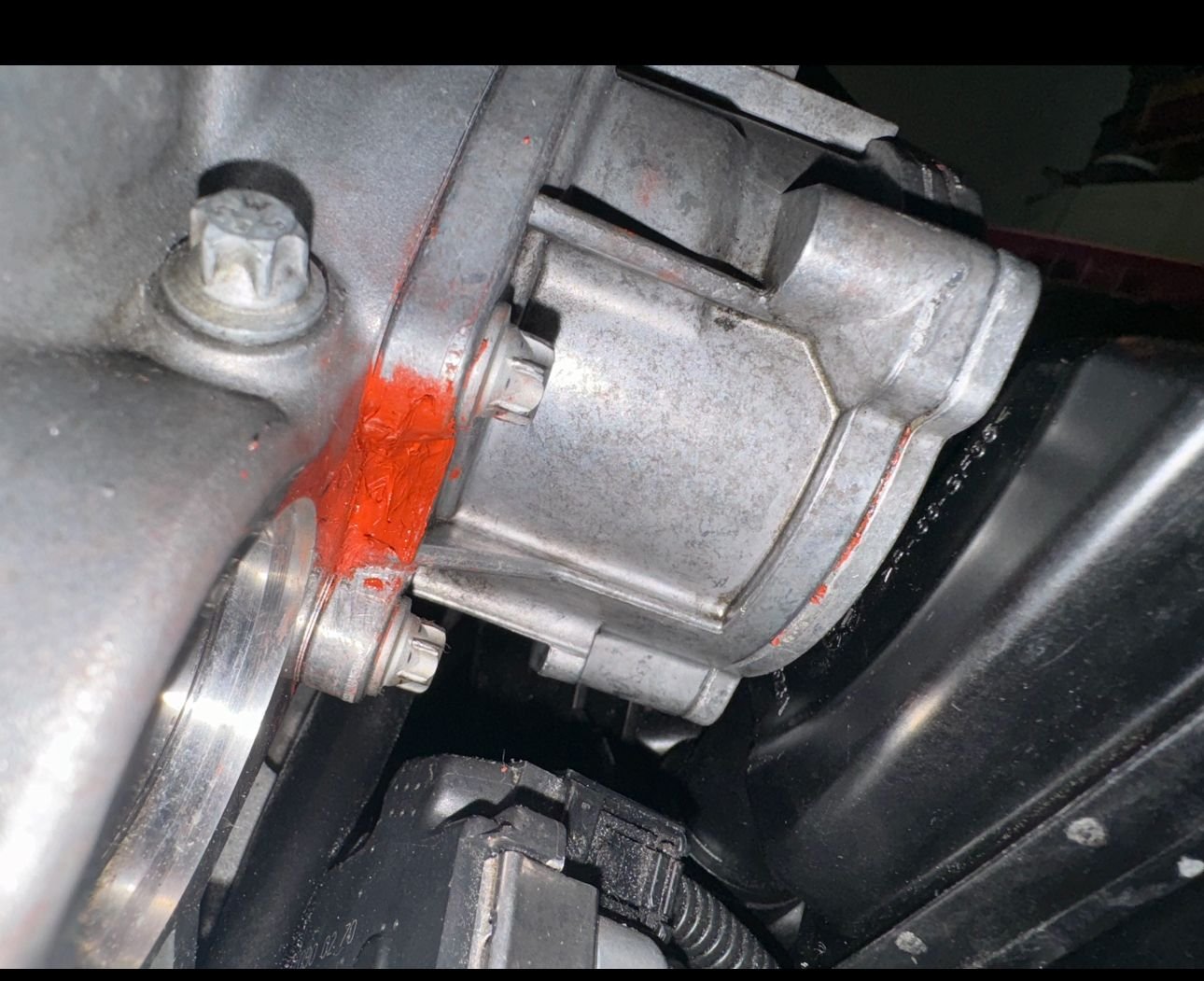

looking more into it, found an oil leak at the region between the vacuum pump and engine block.
First instinct was to replace the $15 gasket that sits between the two. While removing the vacuum pump noticed the lower let bolt coming undone with little or no effort.
anyway, replaced the gasket and used new bolts. Fixed 95% of the leaks.
however, the fix to get the remainder has not been easy! Finally, several hrs later found my issue.
the pump housing does not sit flush against the block.
i can trace back the problem to one of the indie shops that came highly rated for their knowledge of diesel MBs, the first time i had opted to get the oil pan gasket fixed at a non dealer shop in 2012 - the biggest mistake in the life of this amazing car. Have Owned it new since 2008.

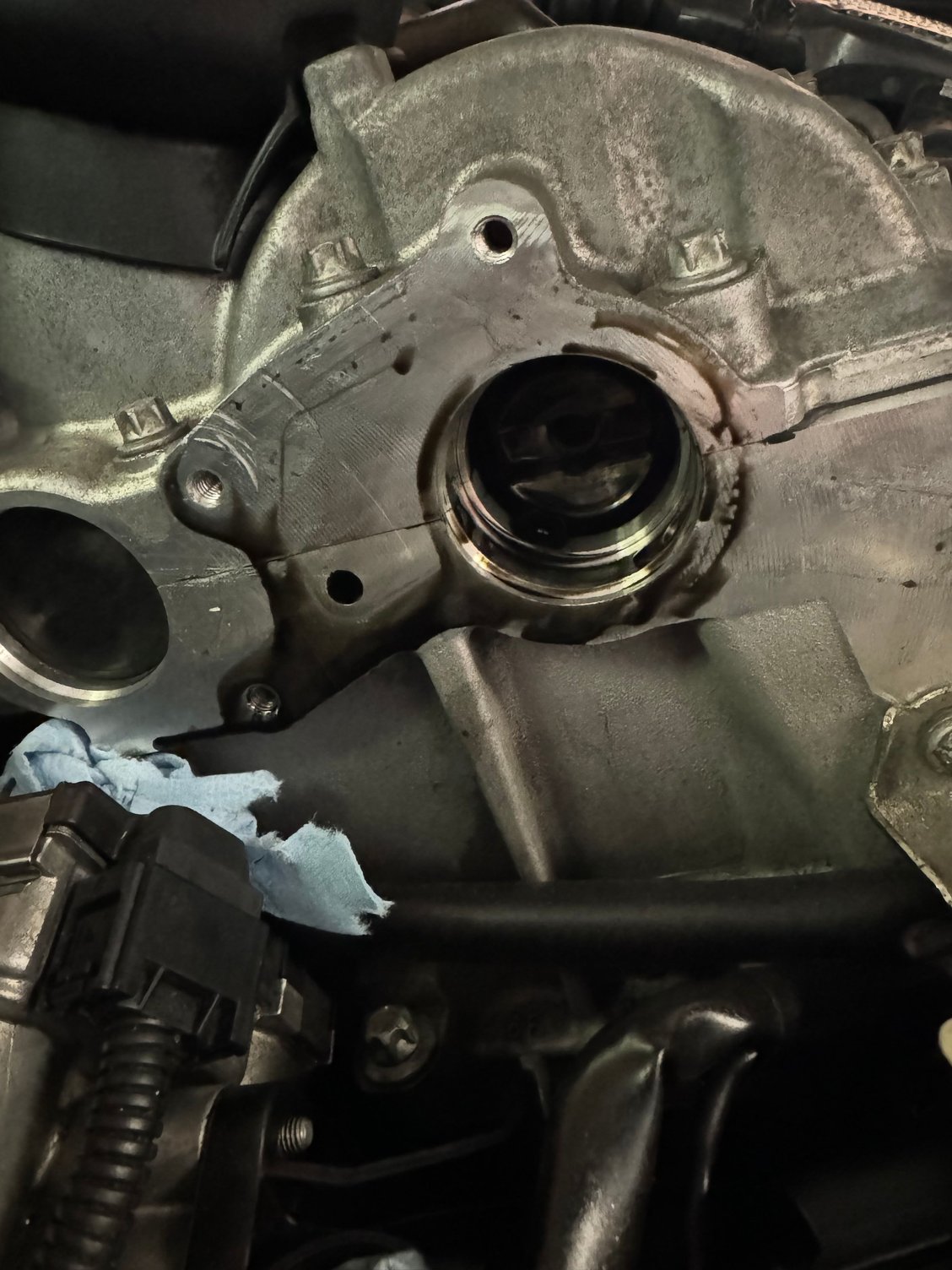

the idi..s have messed with the block - and for some reason used a circular sander across the entire surface of the engine block. They have messed up the flat surface and sanded more at the center - while the 4 sides fit snug the bottom center does not mate flush against the engine block.
used a 3000 grit paper and a hand held block to smoothen out to reduce the uneven surface. (Expand pic 1 and see the center line mismatch and the grooves)
2+ days of work, still couldnt get the surface to line up straight. But it appears the leak is approx 99.5% fixed. There seems like a sliver of a leak that accumulates over time.
for now using high temp silicone to fill the gap. Fingers x’d hope it will hold for some time or until i can get a mini/compact belt sander that can cover the entire area in one go.
comments welcome on the use of hi temp silicone to hold the oil from leaking.

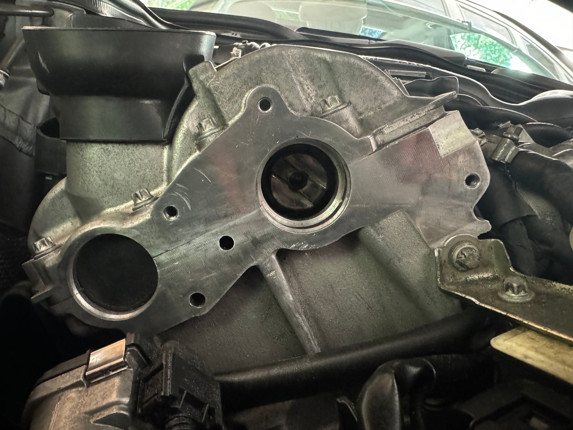

Original surface - pinch tonsee the uneven surface. Path of the oil leak
After several hrs of sanding.

Not v clean application. Hope it holds.
Worry is the sustained exposure to high temperature.
Thoughts anyone?

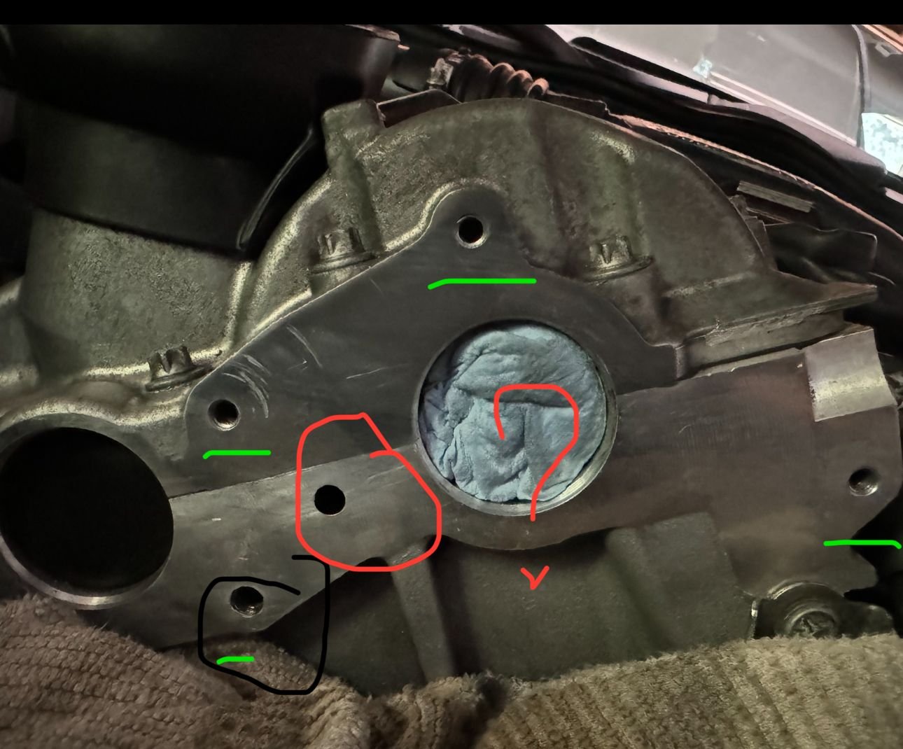

Brake Vacuum Pump - oil leak fixed!!
Hello
fixed the lea k 100%. Made a Gasket using Garlock-9900, and sandwiched it between engine block and the original gasket. No leaks whatsoever, since installed and 150miles later.
however was wondering -
Does anyone know what is the purpose of hole circled in red.?
