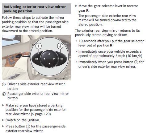

From: UAE
W211 2008
mine doesn't go down at all , any idea how to fix the problem ?
Although it's in the manual, it's disabled on certain years like 2008. Mine doesn't work either. It's covered in some older threads. Guess they were afraid of burning out the motor. Works on my W212.
