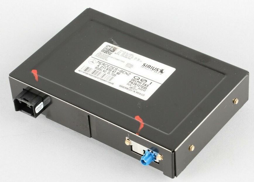

OK not equipped. Check behind right side trunk panel to see if vehicle is pre-wired for satellite radio should be power source & antenna that marry to unit shown. If so, install/activate satellite radio receiver, search current part # 2118706790. Should be plug & play if pre-wired however, if you experience any problems after may need to be coded into MOST loop using MB Xentry (diagnostics).

I added Sirius to my 2005. The installation was plug/play on that generation radio. The only issue I had was when Sirius tried to activate it. The radio froze. I confirmed I have the latest radio P.N for a w211. The solution was to downgrade to the music only (fewer channels) option. I found other posts that talked about the issue. Sirius was clueless. In 2005 the integrated antenna on the rear window did not include Sirius. You may need to add a separate antenna. Mine is currently sitting on the rear package shelf. Reception is OK but it is very sensitive any overhead obstruction, including tree lined streets.

2009 no need for additional antenna, roof antenna incorporates telephone/GPS/satellite radio.
