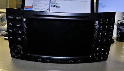

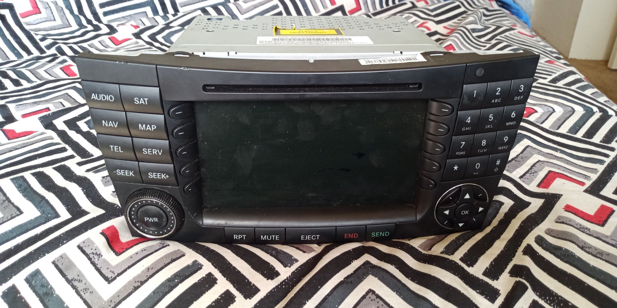

I do have two OEM Comand Units, one from a 2005 E-320(picture) and another one from a 2007 E-550, have install both of them on my 2005 E-320, both units work the same, Nav, MP3, Sirius, Phone but here is my problem, neither one plays DVD, I read on this forums that the older units till 2005 are capable to play DVD(not on the 2007).
My question is: based on the information on my 2005 build on 47/04(picture) is any of this units capable to play DVD's Video and if it does how do I make it work. Will appreciated any comments and suggestions on what to do to be able to play DVD's Videos on any one of them.

you will need euro-spec COMAND which has VIDEO button...
