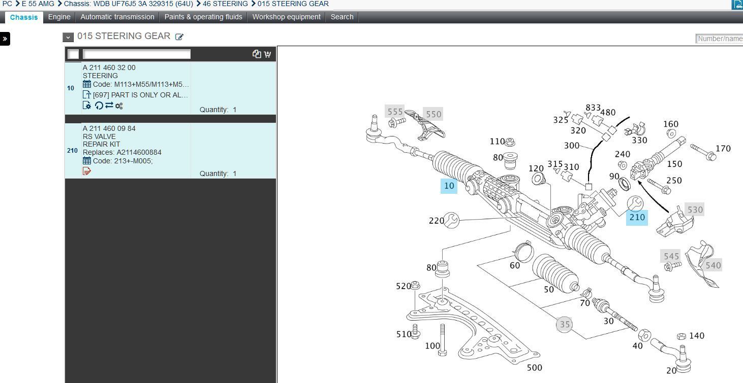

so it seems like every month or so i have to top up the steering rack fluid so i am presuming there is a leak. does this usually mean a new steering rack?os is there an easier fix? also i see a steering rack available as a part out from a same year e55, is it safe to use that rack or do i need to buy a new/remanufactured rack ?

If leaking from valve there is a repair kit (2114600984) available. Same year, same model steering gear should be fine for replacement or shop 2114603200.

that repair kit probably similar price to the used steering rack off a part out, probably better to get the used steering rack over the repair kit isnt it?....to replace the steering rack does mercedes call for many hours of labor?
