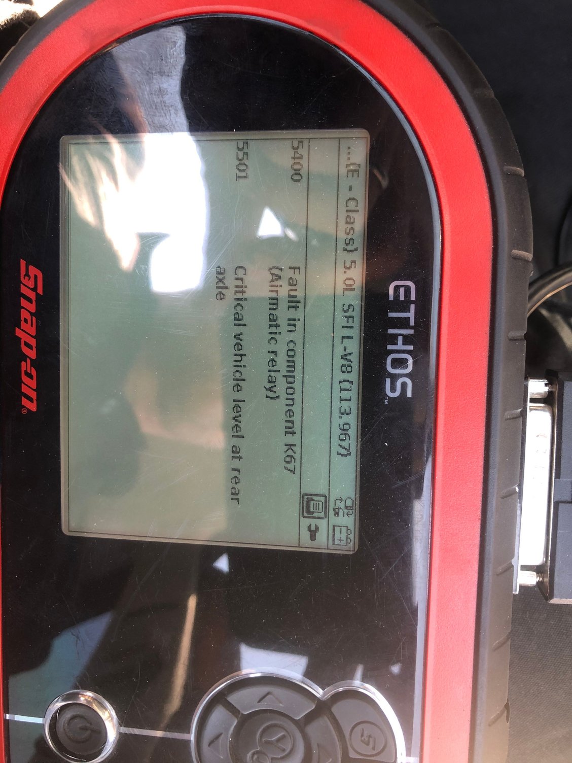

hey , I had a see workshop on dashboard , with car raising pic, took it to a mechanic and it had 5400 code , replaced relay and now the car sits on its *** , won’t raise at all compressor don’t run , had Comp checked it runs so I’m baffled any help please

What's a "repacked relay"?

Replaced not repackaged

Check the airmatic fuses.

Have fun checking the system as it is pretty complex,
Other thing often reported is corroded and disconnected cable at the compressor.

where are the fuses

had power tested , power to compressor solenoid but not to compressor? no power now at relay in engine bay
