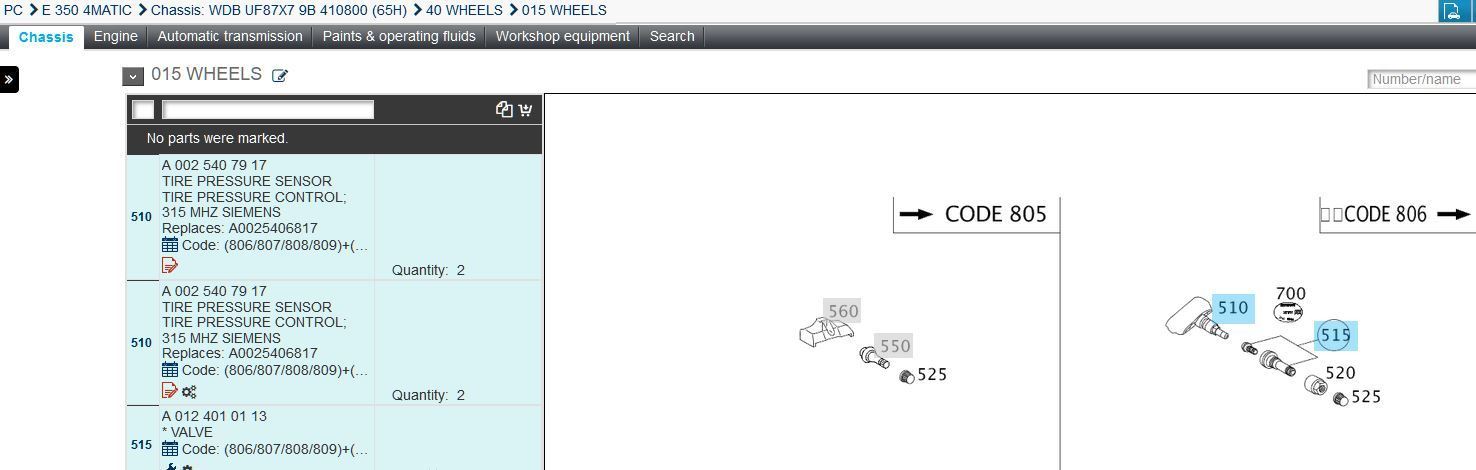

If you are referring to valve (515 in diagram) never heard that before. Sensor (510) however, incorporates a non-replaceable internal battery of which MB recommends replacement every seven years regardless of mileage to answer your proactive maintenance question.
