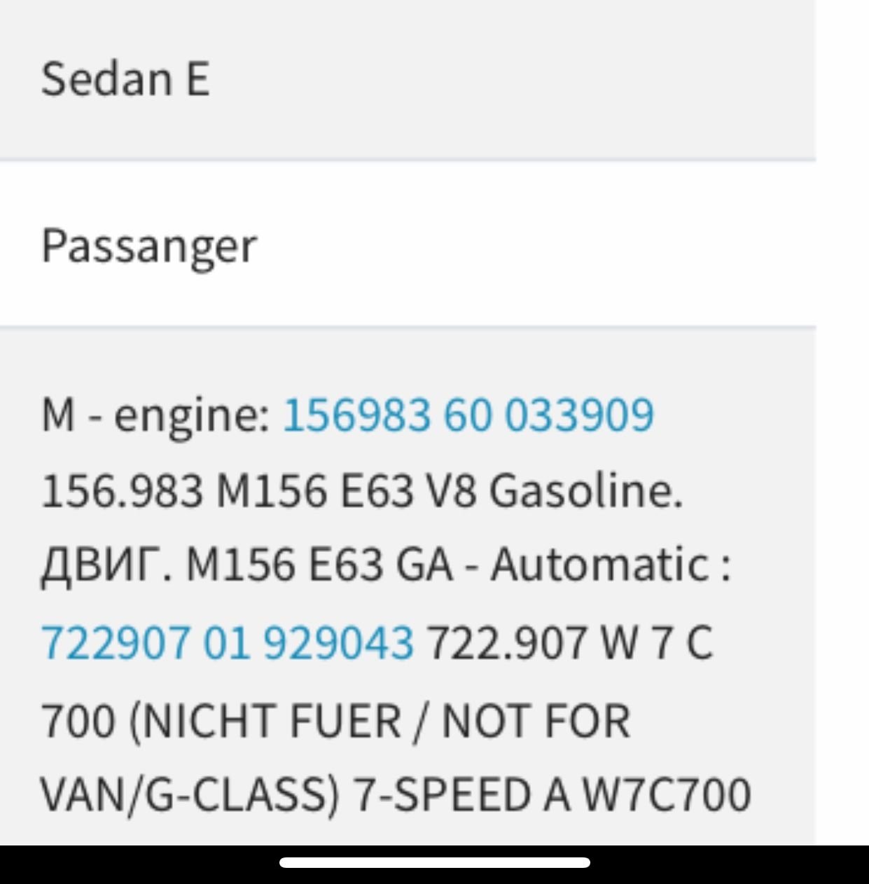

Concerning bolts if your engine # is past 6006058 you should be fine. See attached bulletin and service sheet.
Is this engine good then?
Old Feb 19, 2020 | 05:51 PM
konigstiger's Avatar
Posts: 15,901
Likes: 4,632
From: North Scottsdale, AZ
'71 Pinto
“Affected engine number up to 1569xx 60 060658”, 033909 is affected.
