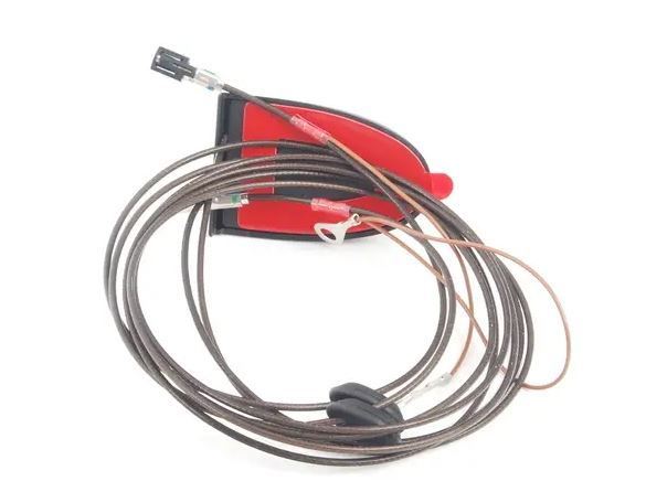

Sorry for bumping an ancient thread, but I would like to know the part # for this antenna as well. Mine is intact but no longer works, and the cable coming inside the car is corroded and the insulation is flaking off. No SOS and I'm off map with no satellites on GPS.

2118203675

I'm searching this part number on various online parts sites and most of them are saying it's for 2007 - 2009 models. Mine is a 2005, with the antenna attached to the glass not the roof. Could you verify this is the correct part number? Also, is there a particular site you would recommend me buying this from? Thanks!

This is the part # MB EPC lists for 2004 & 2005 e320 VIN, wrong! Correct # is 211820357528, image shown.
$107.33 free shipping/lifetime replacement https://www.fcpeuro.com
$83.16 free shipping https://www.ecstuning.com
