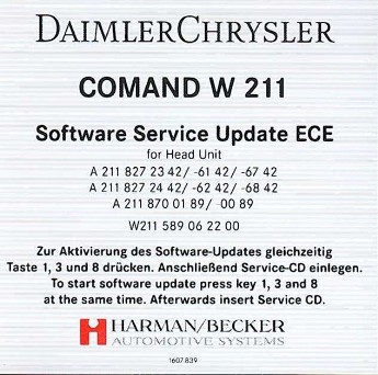

A CD-R works fine for me.
Make sure the have used the version attached below. Note too that it only covers the COMAND Head Units detailed on the cover. They should know which one you have from your VIN.
GL
