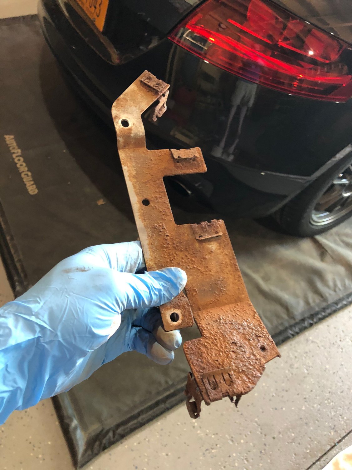

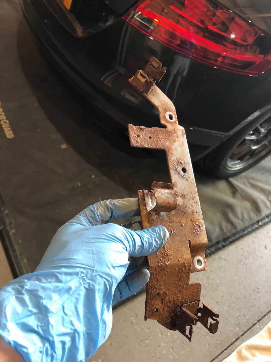

Anyone have a part number for the below pictured part? The bottom of this car is largely rust free, but this bracket is pretty shot. It attaches to the bottom of the transmission, and holds the o2 sensor connectors.

Have you tried soaking it in vinegar for several hours? It will remove the rust. A toothbrush scrubbing will also help after soaking. Then you can spray it with a rust inhibiting primer or paint it. Very easy project and cost would be very low.
