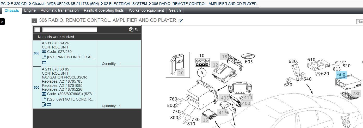

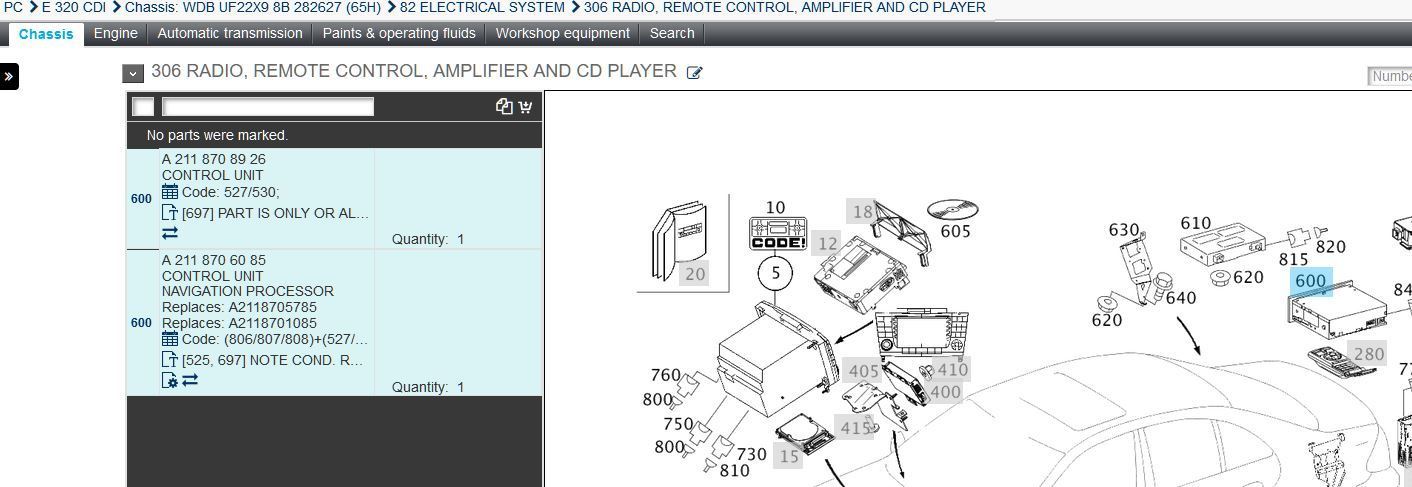

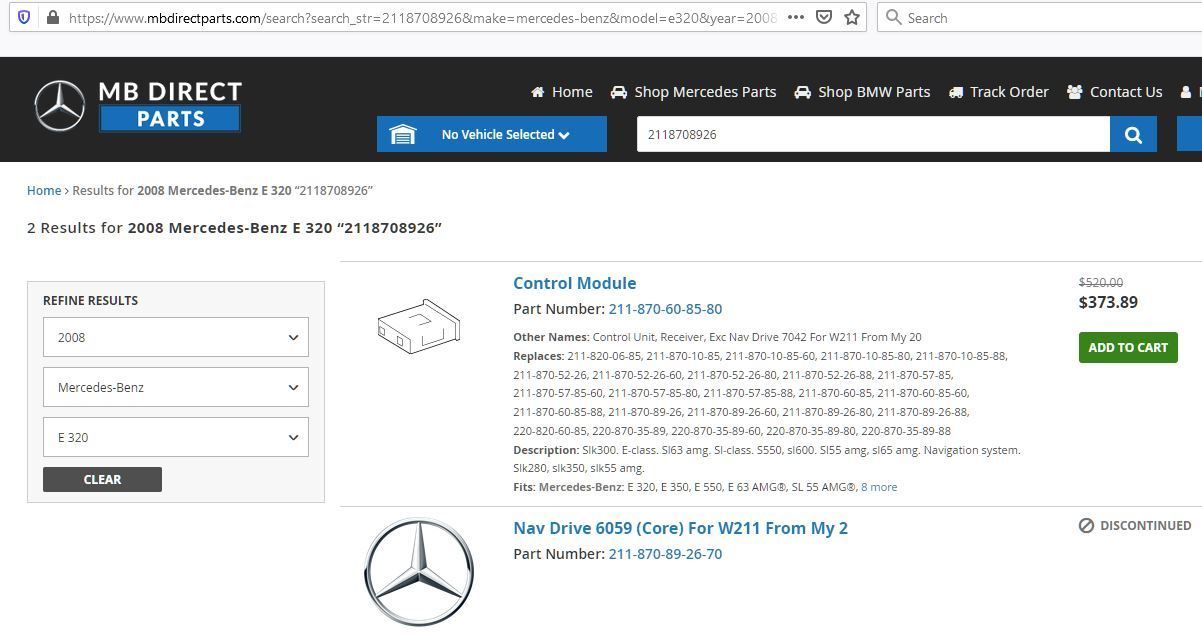

Capture lists compatible navigation processor #s to shop used. Current remanufactured MB part # is 211870608580.

Used comparable vehicle VIN the same part #s apply to your vehicle.

Thanks for the help. I ordered a used unit.

I received the used unit, installed it and it works fine. However, I'm not impressed with the functionality. I'm surprised MB didn't utilize a better navigation system.
