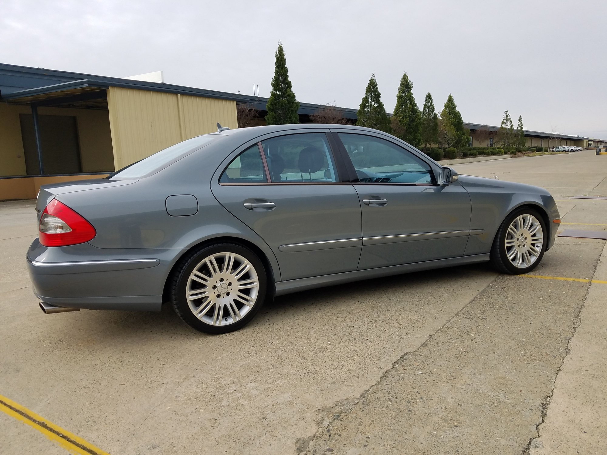

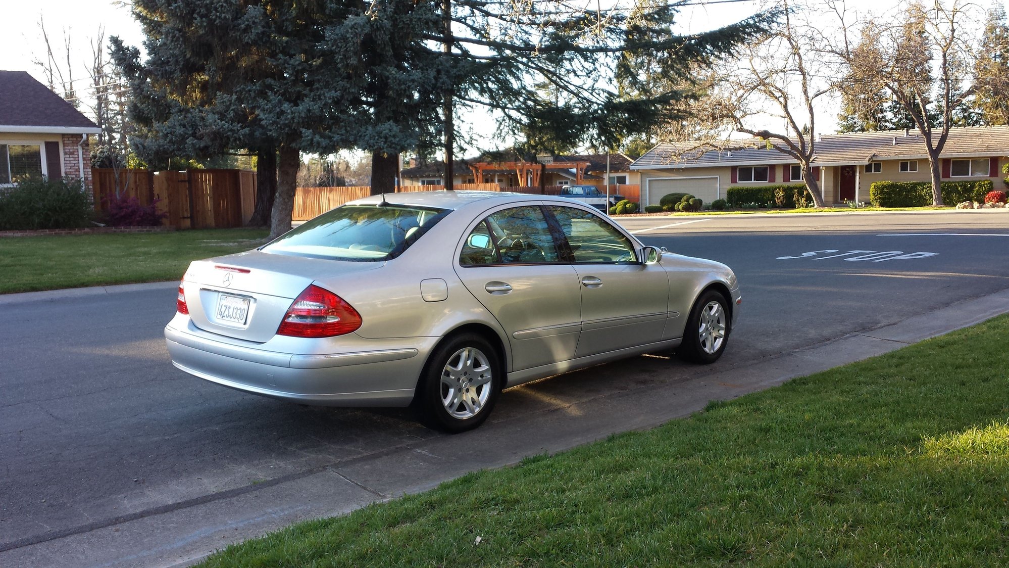

Don't think the width of the tire will make much of a difference in comfort.
Not sure what you have been running before (16", 17" diameter?), but the 18" inch diameter will definitely provide a harsher and not as comfortable ride.
I have 18's on my E350, and they ride way worse than when I had 16's on a previous E320, even with Michelin Pilot Sports all around. However, the 18's definitely look much better.
Are the 18" inch wheels you have OEM Mercedes for a W211, and are you sure that the offset will work for your car? I am pretty sure you can run either the 235 or 245 tire, as long as your rims have the correct offset and therefore will not rub.
