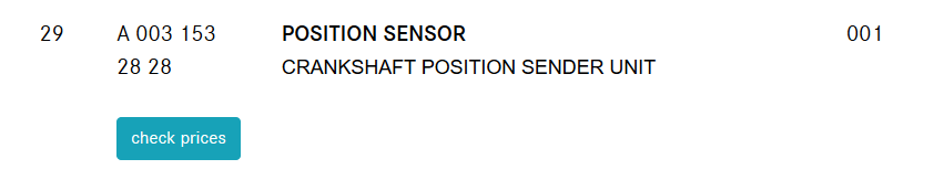

Scheduled to test CPS next week. I will report results here. Does anyone here know an original part number for the CPS sensor or where I can look?
This video below refers to a 2004 model (I have 2003) and shows
p/n VNE 4440, Ref 003 153 28 28. Again my car is (W211) E320i CDI Avantgarde 2003
(min 1:35)

Shown on 272/273 same location for 648, part # 0031532828.

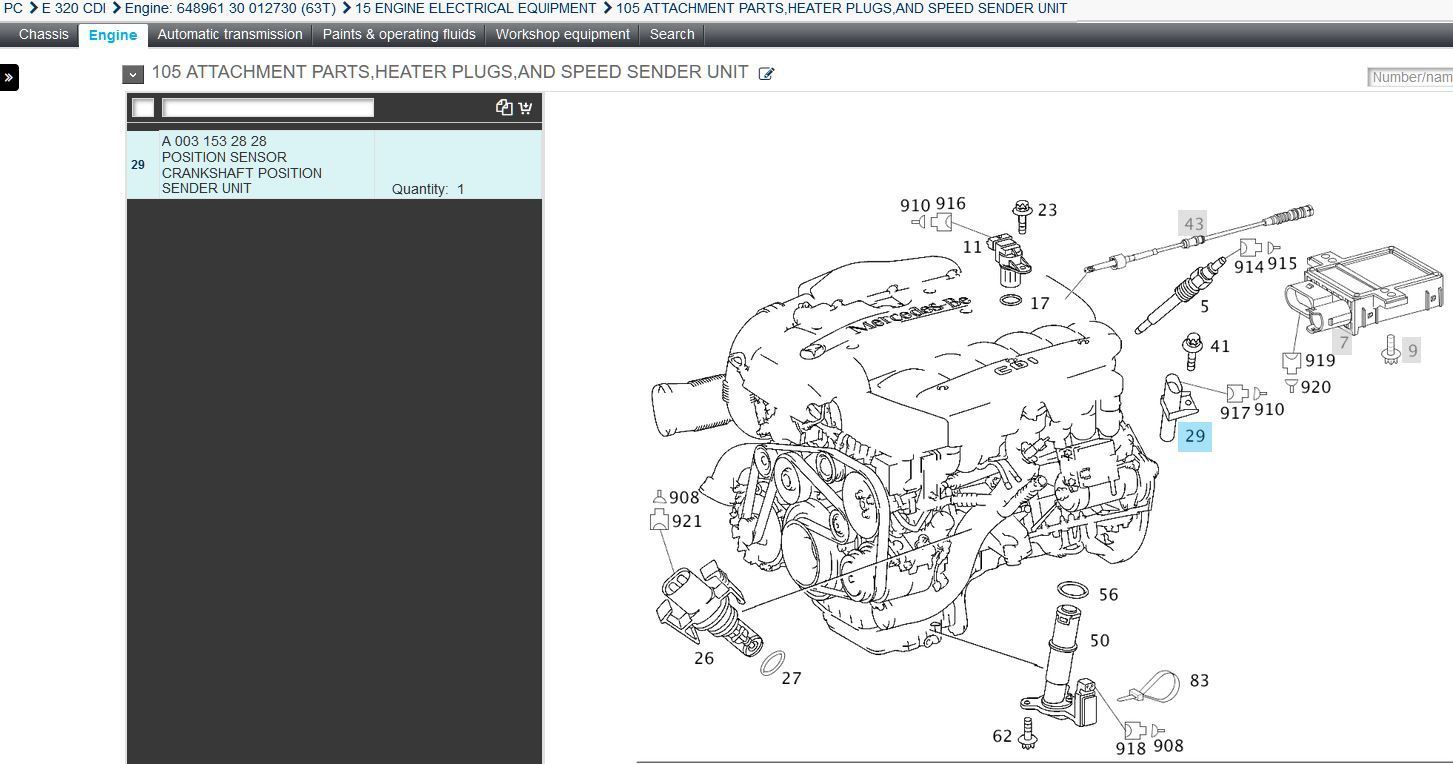

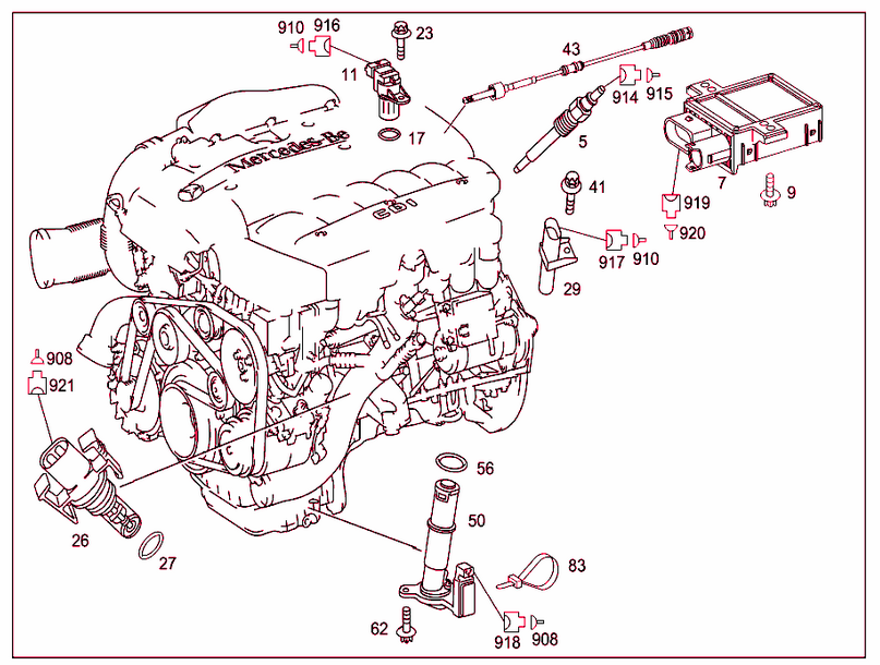

Sorry to post duplicates but I am learning and found this site where I could find precisely my car using the 17 digits VIN code:
http://mbepc.net/en/1/m/om648/63t/64.../105#gsc.tab=0
