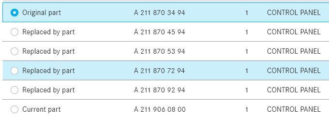

Here are compatible part #s, plug & play.

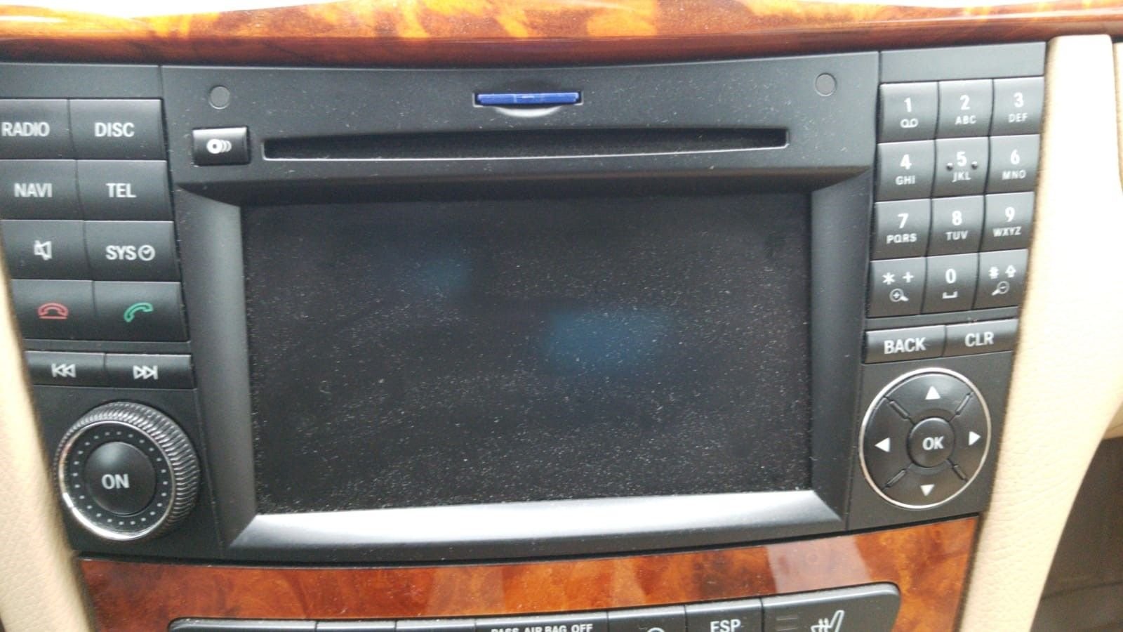

I had a similar problem sometime back. Not sure if you have the same head unit with HK speakers as mine see pic below. The 6 disc CD changer is integrated into the headunit and has a SD hard slot. If so - It could be that the NAV hard disk is failing. This is an AT type HD in the headunit. You can remove the HD which is located in a access compartment at the bottom of the headunit. FYI in 2009 W211 was the last production year before MB moved to the W212. for this year I am learning that MB used the ML 350 headunits (Just in case you are trying to use an aftermarket unit). Good luck.
