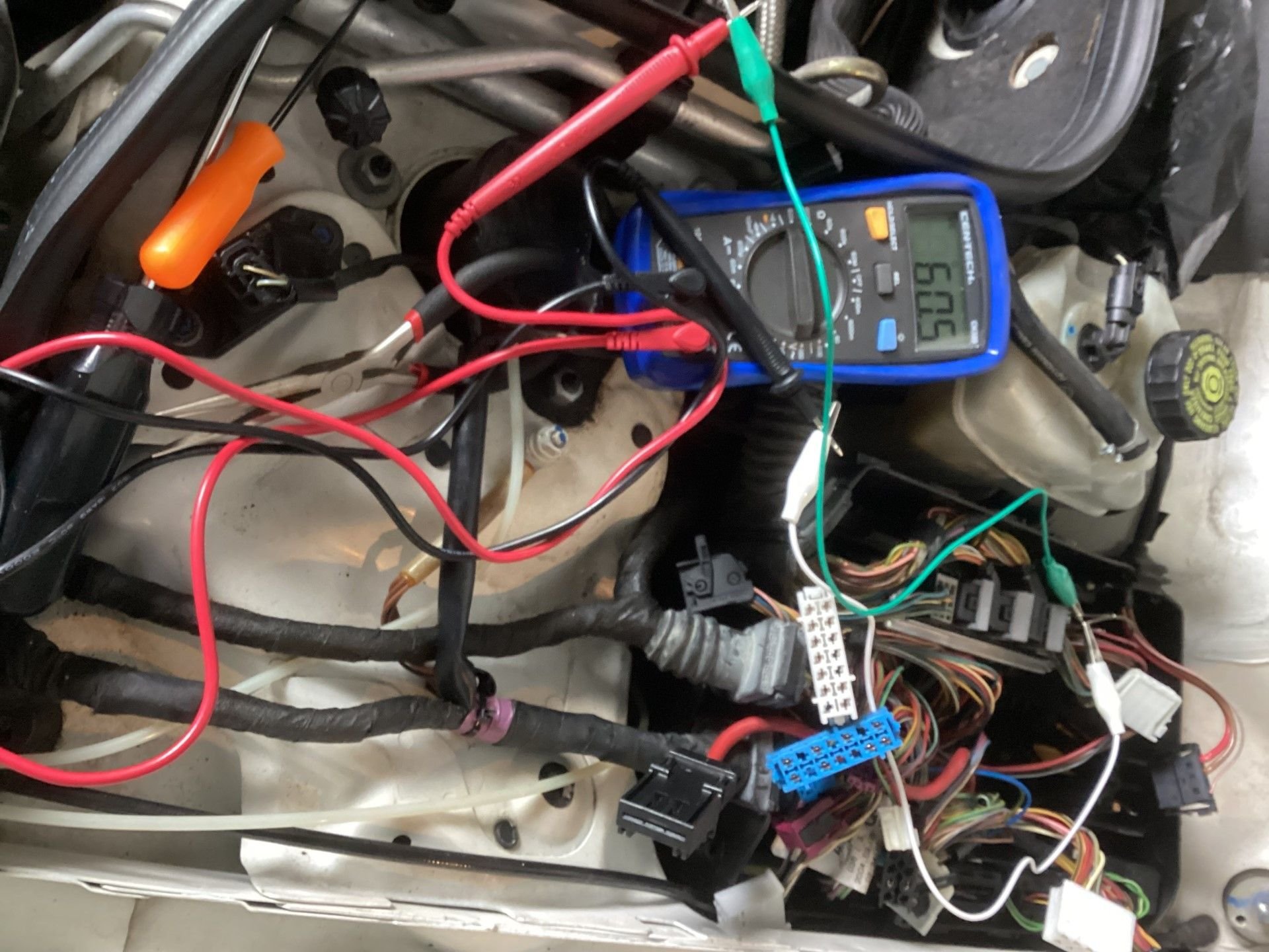

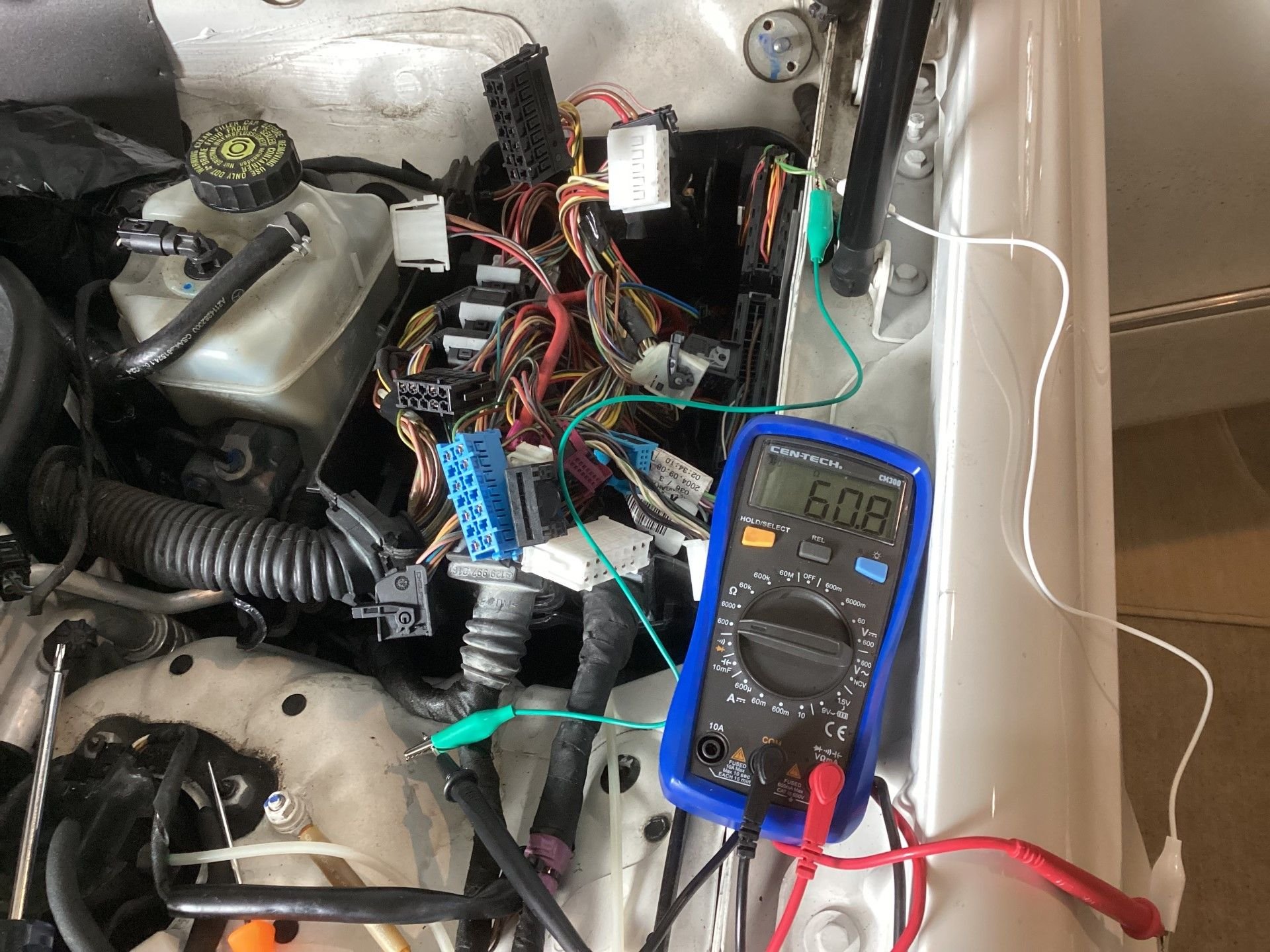

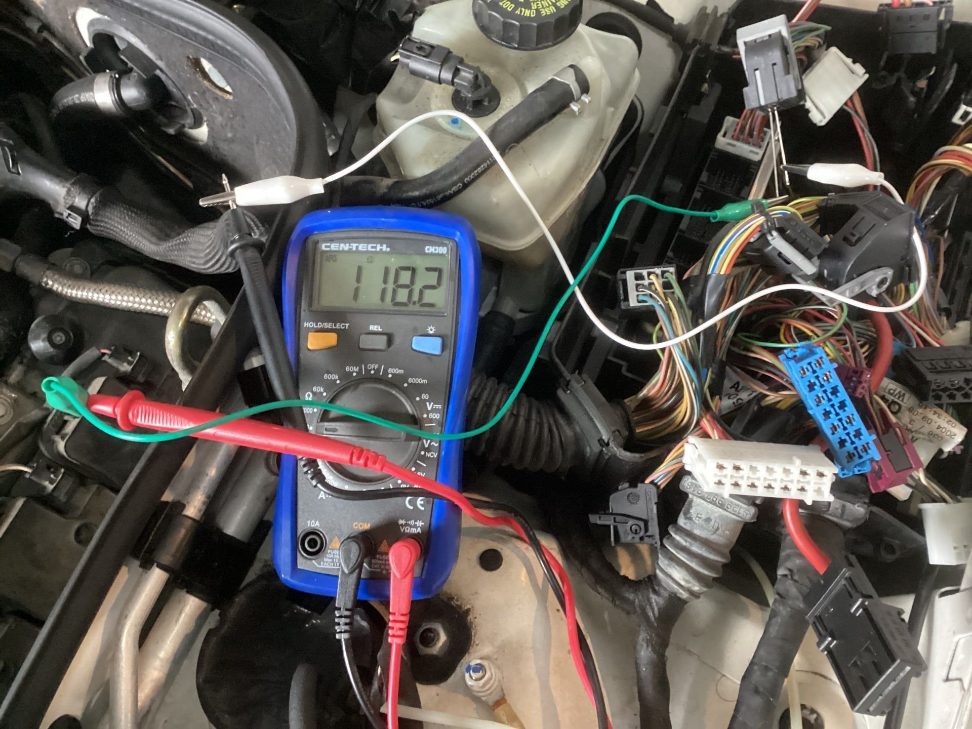

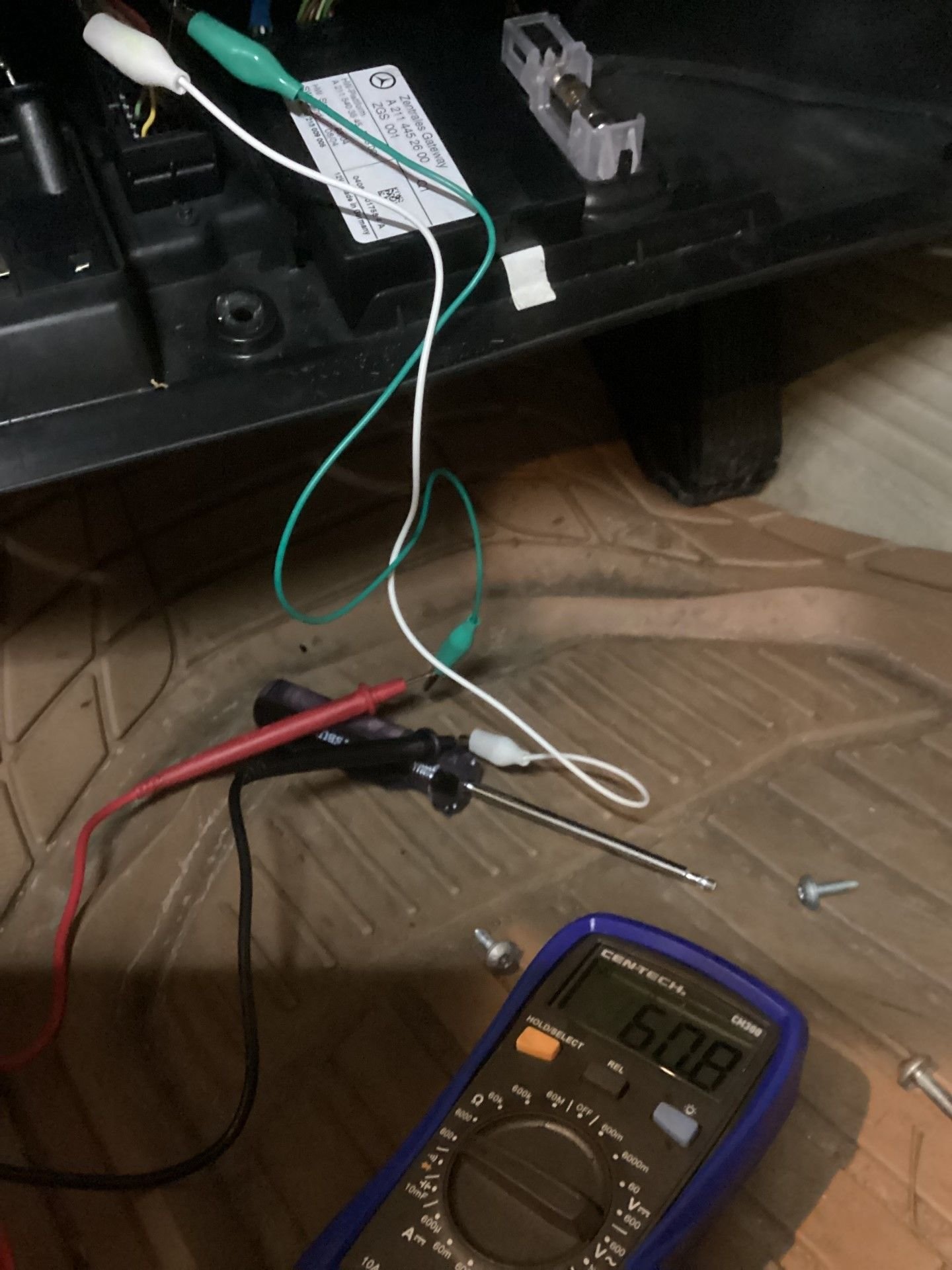

My scanner tool skips CAN-C modules. Orielly's scanner returned "connection failed". The CAN-C distribution block in the driver's rocker panel trough is in clean, good condition and tested functional. No vehicle trouble. Runs well. Scanner reads CAN-B. ECU tested functional. CGW swap out returned same skipping. SAM replaced and initially ran a clean diagnostic report...only to drop CAN-C modules again a few days later. Only DTC: 930E Stored&Current Synchronization of the DTC memory cannot be ensured. This trouble code is not listed from my list of 913 possibilities. I want to use the OBD to take control of the SBC and airmatics if needed. ATM scanner returns "no connection".
CAN diag explained well:
Thank you for your reply. Have a great day.
Some recent pics:
Back probe distal CGW CAN high low
Back probe DLC high low
Back probe ECU CAN high low assembled
Back probe ECU CAN high low disassembled
Back probe ESP CAN high low
