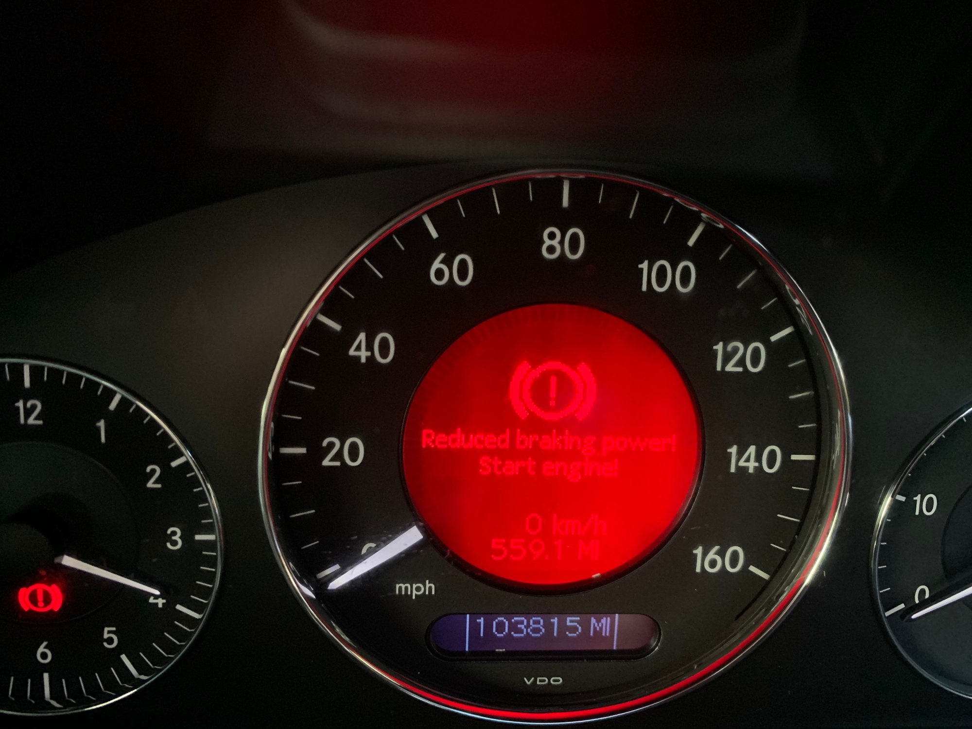

So I just bought a W211 E320 CDI
2005.
when ever I unlock the car and open a door I get the following message appear in red.
Reduced braking power start engine.
I have replaced both batteries, and the brake light switch as a matter of course but it still appears.
is it a fault or is it normal ?
no fault codes using Delphi.
after 30 seconds ignition off it goes.
start engine it immediately goes.
