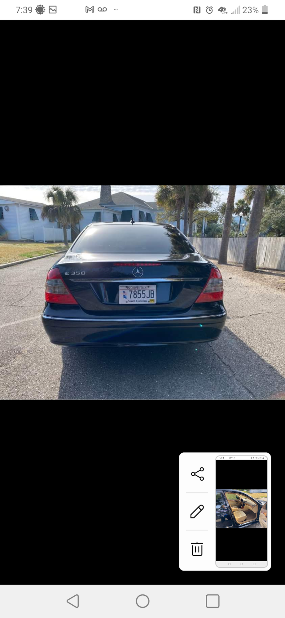

Pictures seems in good shape. Having an inspection done today

no. keep shopping bud.
Not sure what that is on the dipstick, but that's a non-starter for me.

That's a hard pass for me. Those chunks of crud on the dipstick are a big red flag.
My suggestion is don't fall in love with an old low mileage car. There's a lot of differred maintainance you're going to have to catch up on. Find an earlier E320 or E500 with service history, regardless of the mileage. Those engines regularly go 400k+ miles. The E350 just doesn't. It's nowhere near as reliable.

That looks like someone tried running the full 10k mile oil change interval with dino oil, or just hasn't been changing the oil period. All of the oil passages in the engine and the hydraulic valve lifters are probably sludged up. I wouldn't even consider it after seeing that dipstick, not to mention the drivers seat, if the cover looks like that the foam has to be broken down as well and would be uncomfortable in no time.
There are enough of these cars out there that have been maintained properly, I'd keep looking. Just avoid the 06-07 model year E350s due to the balance shaft issues.

Jesus, good thing you pulled the dipstick. That looks awful. Pass.
