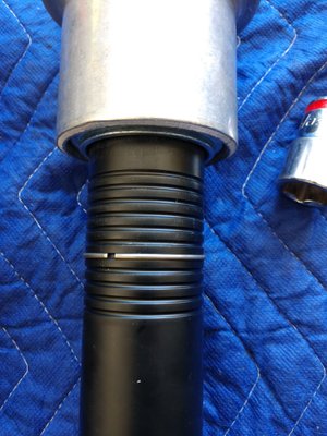

Stock factory coil overs are adjustable.
how? I don’t know of any adjustability on stock springs...
OP GET COILOVERS. I have BC. If you go thru the trouble of replacing the air suspension, get something adjustable and worth your time. If springs are too short or long, that’s just what they are. COs can be adjusted after the fact. Do it
Well now you know.
https://www.benzworld.org/threads/lo...hocks.3029894/
