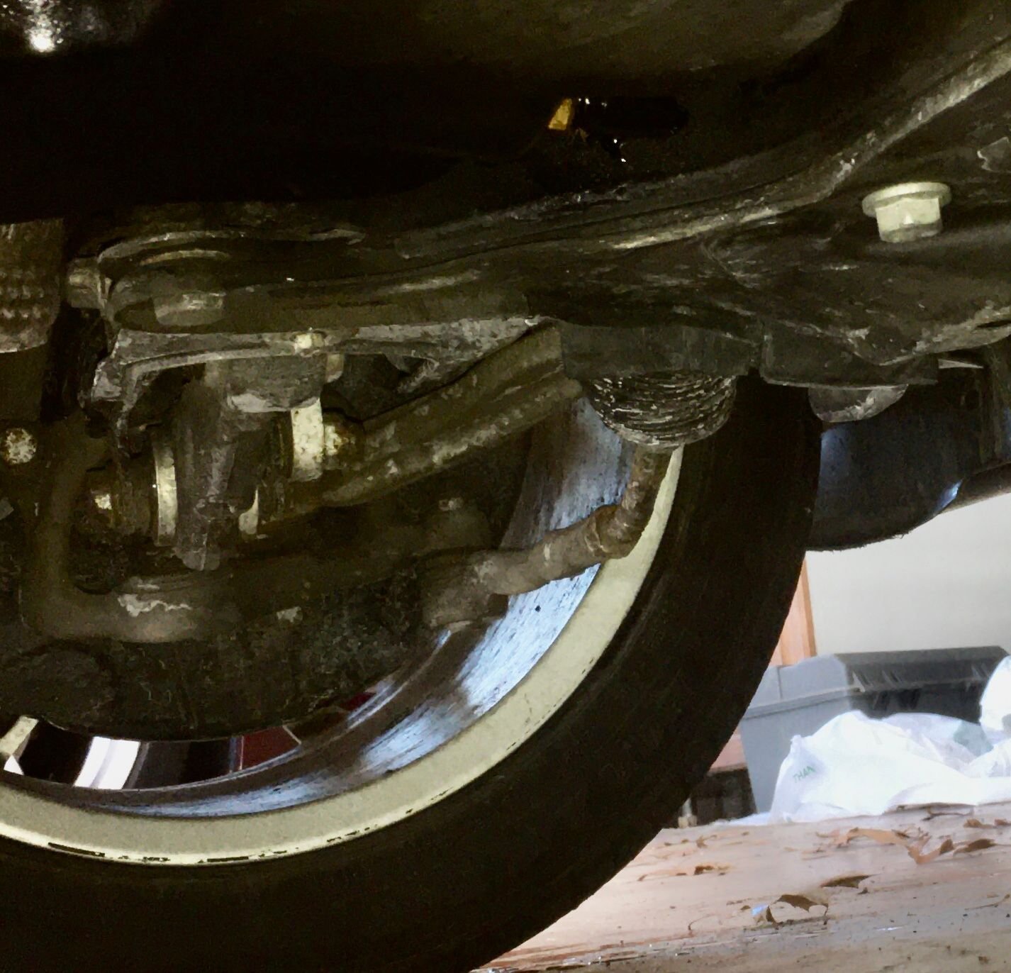

My wife hit a monster pothole, and now the car starts up normally, no lights on the dash, and the abs works. But after a few hundred yards, the comp detects the steering is massively screwed up and says ESP inoperable, see owners manual. She hit a pothole on the front driver’s side wheel and now the steering wheel is crooked by 1/4 turn counterclockwise. My deductible is going to be like $1,500. Is it worth it to make a claim or is this going to take way less than that. The tire is seemingly fine and the wheel is seemingly not bent at all. Kind of weird that all the shock went into what seemed to be destroying only the most expensive parts of the car, but it’s that kind of week. Just bought four new tires, and got it aligned. Plus it passed inspection needing literally nothing....I was really happy about that for an ‘07 MB. Back to earth now. Anyone know what might be wrong?
Edit:
$360 bent inner tie rod end and no other damage. Not even a sidewalk bubble or bent rim. If that’s what you might want your tires to do:
245/45R-17 SUMITOMO HTR A/S P03 XL

MBAsher's Avatar
Joined: Feb 2021
Posts: 10
2007 E320 Bluetec
Heck yeah
Originally Posted by kjb55
I'd say that's good news. $50 bucks for both inner and outer and if you're not capable - any alignment shop could swap those as part of the alignment. Incredibly easy to change. Honda's must have the capability to jump over pot holes.
Think the outer could be ok or probably not? I snagged a new inner for $30. Could still have major issues, but I doubt it. If some steel that thin started to take enough force to bend, I doubt anything like the frame started to give. It would probably just keep bending the weakest point. Weird situation because the tire and wheel are fine. And I’ve had those wheels straightened before like 1-2x each. They’re made of marshmallow. Must have been a really diffuse impact. And these tires are no joke, they’re some new super hard and noisy Sumitomo tires, 540 AAA. I think I’m never going back to another tire if these things can protect the rim like that. Not that I prefer the tie rod bending, I don’t think that would happen from a typical pothole. A plough ripped up the road and it left a deep hole big enough for the whole wheel to fall into. Penndot already filled it and if you know Penndot, that’s saying something.
Here’s a good shot of the outer.

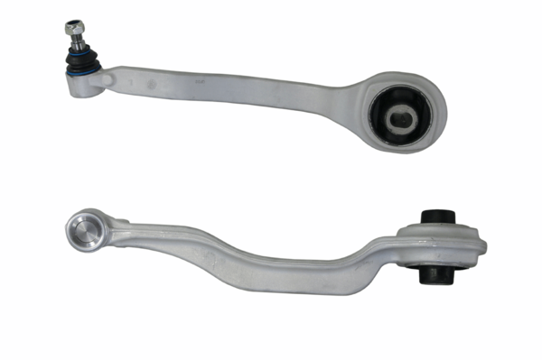

If the steering tierod us pretzeled like that I'm willing to bet the forward lower control arm is also bent. It's made of aluminum with a big bend in the middle ripe for deformation. It's right there next to the tie rod. The rear steel control arm (pictured) that the coil over is attached to is damn near indestructible.
Also when you put a force like that throgh the steering rack, you're going to damage it internally.

Originally Posted by MBAsher
Think the outer could be ok or probably not? Here’s a good shot of the outer.
From that photo it doesn't look bent to me. The inner is metal and the outer plus other parts cast - I would look for fracturing also. The other components can be measured against the other side to determine what's bent. The alignment machine will verify caster, camber, toe, etc. and reveal any other suspect parts for sure. The front ends are pretty robust - check this out...

It’s in a good shop as we speak. I think the bend makes sense. If you somehow froze one wheel on the driver side like she did while steering in a straight line. The car would have force moving forward about 45 degrees to the left of center. If the weakest point was a straight rod going from center to frozen wheel, it would bend exactly like it did. The wheel couldn’t turn. So the car had momentum going left and expended it bending metal to get the left wheel to take a shorter path than the right wheel. I’m glad it didn’t cause the car to do a 90 degree turn.
