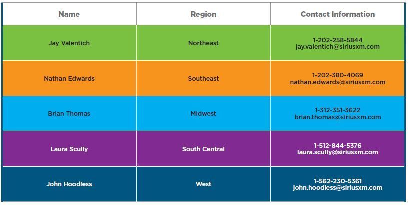

As suggested request SIRIUS enter your EIN into a "protected tier" in their computer system so that when they tell their system to send all channels, radio (head unit) does not lock up attempting to accept more channels then it is designed to hold. Not sure if contact info is current (dates back to 2019) but in case customer support stonewalls:
