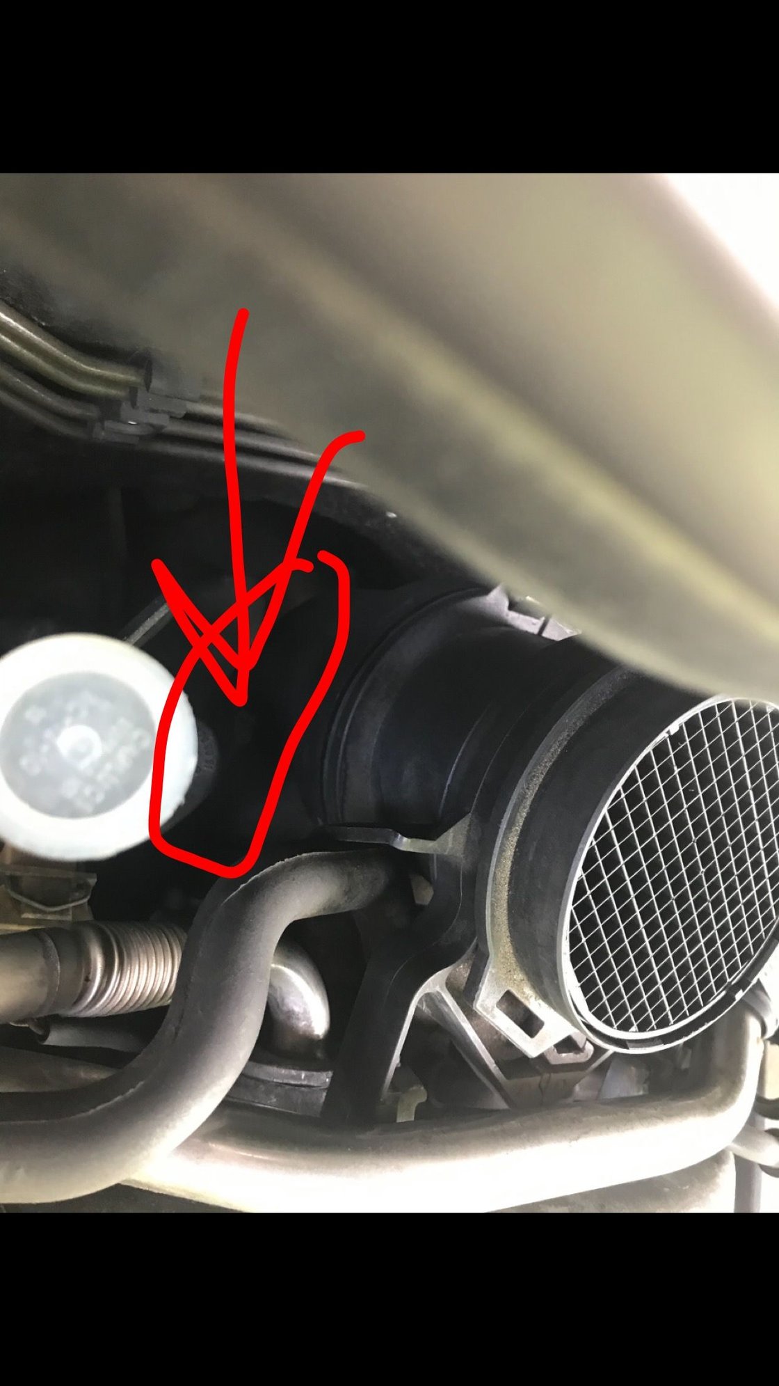

Removing part below mas air flow sensor
Hello guys I’m back so I am having a hard time removing the the elbow shaped tube that is in between the MAS
airflow sensor and the throttle body , any tips?

There are two plastic clips. I think there are two, but maybe one. It is down low. You have to release the clips in order to get the elbow out. Try using a long flat screwdriver to help release it. You have taken off the top portion first? There should be some online guides showing how to take it off.
Once you've gone over all the basic maintenance stuff, if you still have an issue, I would suggest finding a local Mercedes mechanic. The basic maintenance you have to do regardless. Might as well save money doing it yourself. But if it doesn't solve your throttle problem, then instead of throwing money at it, find a trustworthy mechanic familiar with Mercedes. Might save you time and money that way.
