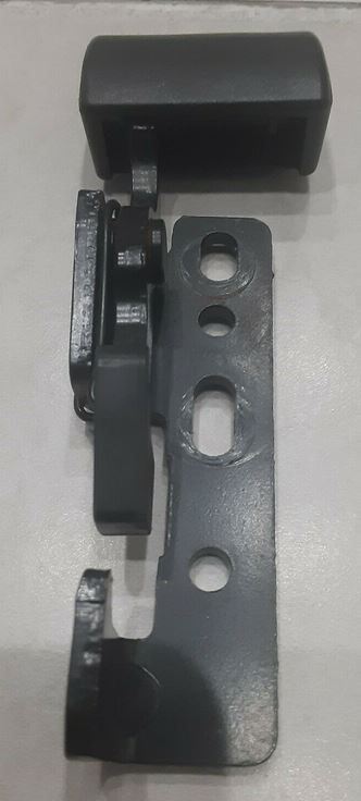

Check release levers, part # 2119200572 if replacement needed.

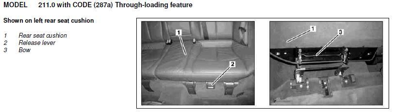

I had a closer look to understand how it works. Good news - appears to be user error...
Important tip when folding the cushion back down is that it folds on a hinge first, then pushes back into the locking mechanism. Make sure to 'fold' before 'pushing back' - two distinct movements.
